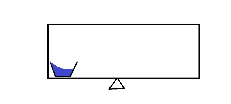

If you put bucket with water close to wall,will be water behaves identical like accelerate in straight line car?
I think will, so I said there is no difference in acceleration due to moves in circle or accelerate in straight line.
But if bucket is set at the center of G-room,, water will take U-shape.
From ground frame bucket with water set at the wall of G-room rotate around itslef because it change orientation.
If we stop rotate G-room, will be water inside bucket continued to spin for some time?
John Mcrain said:
If you put bucket of water close to wall,will be water behaves identical like accelerate in straight line car?
It depends on how large the bucket is compared to the radius of the centrifuge. The centrifugal force is not uniform like the inertial force in linear acceleration of the car.
John Mcrain said:
But if bucket is set at the center of G-simulator,, water will take U-shape.
The water surface in the bucket placed in the cabin of the G-simulator also forms a section of that U-shape. But if the bucket is small compared to the radius of the centrifuge this might not be noticeable, and just look like a tilted plane surface.

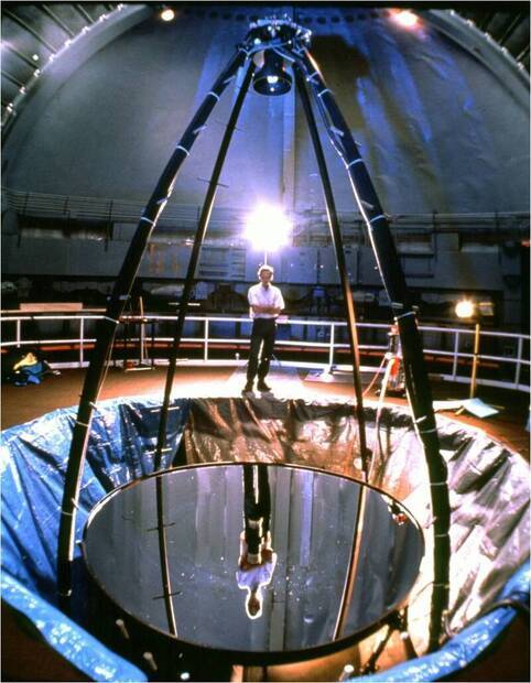

John Mcrain said:
What casuse this U shape when bucket is at wall in Groom?
The parabolic surface extends throughout the Groom. You can sample that curved surface with a bucket of water anywhere in the room.
https://en.wikipedia.org/wiki/Liquid-mirror_telescope
What do you mean by "U shape"? Once the rotation axis is outside the bucket there will no longer be a dip in the middle of the bucket, sure, but the water height will still vary in a paraboloidal fashion - just a very off-center paraboloid. This is because the apparent gravity points to the center of rotation, which is at a slightly different angle to a straight wall at different points.
I assume by apparent gravity you mean the combination of Earths gravity and centrifugal force. Its direction varies because the centrifugal force is non-uniform.

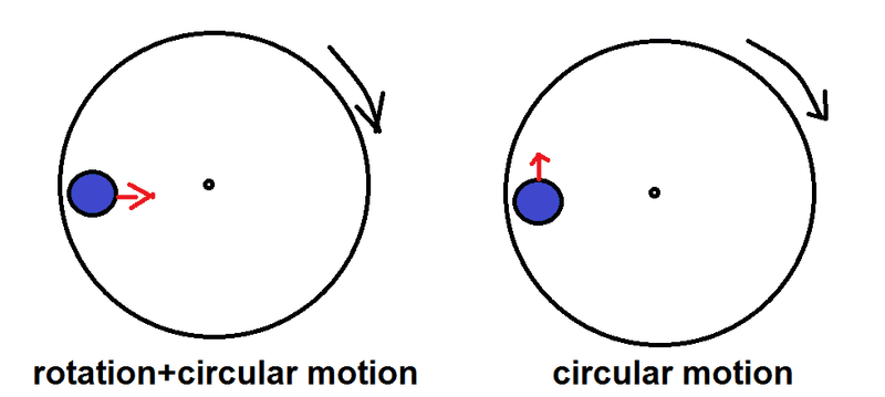

You mean like this?
If we stop rotate G-room when bucket is at the wall, water in bucket will still spin some time. That is proof that water also rotate about itself during G-room rotation.
Does it mean we must add together effects of water rotation(U shape) plus effects (parabolid shape ) of water circle around Groom pivot point, when G-room is rotate?
John Mcrain said:
You mean like this?
Yes.
It'll do a lot of sloshing around and quite possibly knock over the bucket. If it doesn't fall over the forces on the water from the decelerating bucket walls will move the rotation axis of the water to somewhere near the niddle of the bucket, yes.

  • #32
Ibix said:
No.
in left case bucket is facing allways toward center (roation+circualr motion) and in right case bucket point for example allways to north(only circular motion)
How can then water in bucket behaves the same in this two cases?
