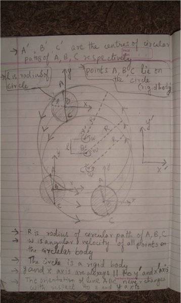

in the figure a rigid body - a circle- is moving such that its centre is moving in a circular path but the orientation of the body is fixed with respect to the centre of the body (the circle). According to def of rotion of rigid body -
Rotation of a rigid body about a fixed axis is defined as the motion in which all particles of the body move on circular paths with centers along the axis of rotation and planes of rotation normal to this axis.
Will the body (as a whole) be considered to be ROTATING about axis "A" ?

Are the particles in the circle undergoing rotation about the centre of the circle? If yes, then the answer to your question is no.
If no, then yes the entire system can be said to be undergoing rotation about A.
This a detailed diagram of the same scenario.
1st ) The centres of the circular paths of the all the particles of the body do not join to form a straight line which violates this -
hackhard said:
all particles of the body move on circular paths with centers along the axis of rotation .
2nd) the line joining the centres of the circular paths of any 2 particles of the body is not normal to the plane of rotation,which violates this -
my question - Will the body (as a whole) be considered to be ROTATING about axis "B" ?
All the particles in the rigid body are undergoing rotation about their own centre. The rigid body as a whole undergoes rotation about an axis outside the body. Both the angular velocities may or may not be different. The particles of the body are NOT undergoing rotation about the forementioned axis. Done.
No.
They are undergoing translation along circular paths, not rotation.
I meant if they rotate they will do so about the circle's centre.
CrazyNinja said:
I meant if they rotate...
Why should they?
Sure, just fix a Cartesian system with the body with origin in B and rotate the entire body, including this body-fixed reference frame, around A. Then B will rotate around A but also the body-fixed reference frame will rotate.
