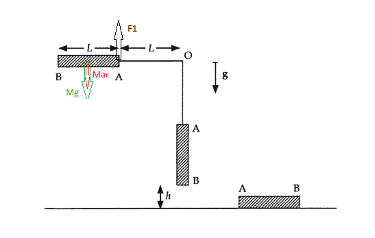

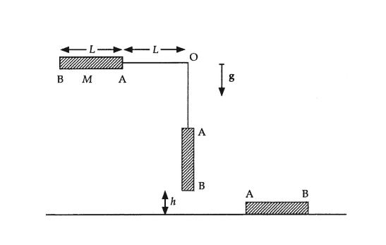

A thin homogeneous rigid rod has length L and mass M.
One endpoint of the rod is fastened to a light, rigid steel wire, also of length L.
The other end of the wire is fastened to a horizontal axis O in the laboratory.
The system can turn in a vertical plane. The steel wire cannot bend, and its
mass can be ignored relative to M.
Initially the system is held at rest in a horizontal position. It is then set
free to move under the influence of gravity. The acceleration of-gravity is g.
Ignore air resistance.
(1) At the moment the system begins to move, i.e., while the rod is still
horizontal, the wire acts on the rod with a force F1 at the endpoint A.
Determine F1.
(2) At the moment when the rod is vertical, the wire acts on the rod with a
force F2. Determine F2.
(3) Assume now that the steel wire breaks at the moment when the rod is
vertical. The lower point B of the rod is then at some height h above the
laboratory floor. When the rod hits the floor is has turned so that it is
exactly parallel to the floor. Determine h.
Hi,
I started with calculating the moment of inetria of the rod:
I = ⅓ML^2 + M(3/2 * L)^2 = 31/12 ML^2
and I thought that the reaction force in the first case will be equal to centrifugal force:
F1 = Mω^2*(3/2)L
Angular velocity is calculated from the conservation of energy:
Mg3/2*L=1/2 * Iω^2
But this solution seems to be incorrect.
How do you know that ?
And: would that be for part (1), (2) or (3) ?
You write
in the first case
but at that point ##\omega## is still zero !
I started with calculating the moment of inertia of the rod:
Not needed for part (1) :smile: !
And you make a mistake that I can't point out because you don't say how you are doing it.
You appear to be applying the parallel axis theorem, but one of those two terms on the right is incorrect for that,
I got the result: F1=(54/31)Mg, and the correct answer is (1/28)Mg.
I'm trying to solve the 1)st part :smile:
Yes, I wanted to apply parallel axis theorem. It seems that I should rather use (1/12)ML^2 instead of (1/3)ML^2. In part 2) it gives the result: F2 = Mg + F(3/2)Lω^2 = (41/14)Mg, which is correct :smile:.
But I'm still struggling with the 1) part.
Ok, that helps. You follow @haruspex and my advice to come up with a better moment of inertia [edit: I see you already did that! Kudos ! ], and try to set up the proper equations for what we shall call ##t=0##.
A free-body diagram might be extremely helpful .

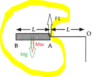

I guess the center of mass will be affected by the force F=Matangential
atangential can be calculated from Iα=Mg(3/2)L
Therefore α=(9/14)g/L, and atangential=(27/28)g.
But both forces: Mg and Matangential should be pointed downward, so why shoud they be subtracted to obtain correct result?
Free body diagram of rod alone is within yellow marker line.
Free body diagram of rod+stiff wire is without all the vertical crud.
[edit] and without ##F_1## but with another force elsewhere ... :rolleyes:
(I should have been more specific ?)
What kinds of motion for the rod are going to happen with these forces acting ?
How are they interconnected ?
Equations, equations :wink:
why should they be subtracted to obtain correct result
Because they point in opposite directions, perhaps ?
##a_{\text{tangential}}\ ## can be calculated from ##I\alpha = {3\over 2} MgL##
Is that so ? All of a sudden ##F_1## is out of the game ?
generally speaking the wire acts on the rod by means of a force and a torque
The general is correct, generally speaking
Yes and in particular one should prove that the torque is equal to zero. If it is so indeed. The force F1 is not obliged a priori to be directed vertically as well
Not a priori, no. Generally speaking :wink:
But yes at ##t=0##
BvU said:
But yes at
this must be verified
Done.
Note that this is not my exercise, but roadrunner's ...
Perhaps these remarks will be of some use for the topic starter
luckily here we easily verify this by seeing that the centre of mass ##S## is constrained to move on a circle of radius ##r = 3L/2## with ##\dot{r} = 0##, so it's acceleration ##\mathbf{a}_S = r\ddot{\theta} \boldsymbol{e}_{\theta}(t) -mr {\dot{\theta}}^2 \boldsymbol{e}_r(t)##, where ##\theta## is the angle from the horizontal. so with ##\dot{\theta}(0) = 0##, the ##\mathbf{a}_S(0) = r\ddot{\theta} \boldsymbol{e}_{\theta}(0) = g\boldsymbol{e}_{\theta}(0) + \frac{1}{m} \mathbf{F}(0)## implies ##\mathbf{F}(0) \parallel \boldsymbol{e}_{\theta}(0)##
It is unclear. We are told the wire cannot bend, but not whether its joint with the rod can flex.
Post #5 tells us
BvU said:
Post #5 tells us
Does it? It implies that when the rod is vertical the wire is also vertical. Can that only be the case if the joint is rigid?
@haruspex I presumed that the rod and the wire form a single rigid body; or in other words, that the wire is welded to the rod and can exert both an axial and shear component of force on the rod, and the shear component has to be non-zero whenever the rod's angular momentum about its centre of mass is changing.
Yes, I agree that is probably what is intended. But.. why does the question only ask about forces, not torques?
Likes etotheipi
haruspex said:
Does it?
OK, I thought you were referencing the second part of post #5,
Exactly! The wire is rigid and it is rigidly connected with the rod. . It is the cause why the wire can rotate the rod and thus the wire can apply a torque to the rod.
You can take the wire in your hand and rotate the rod by means the wire
"The wire cannot bend" is different from "the connection between the wire and the rod cannot bend". But the intent is made clear by the textbook answer to q1, as @BvU notes.
Likes wrobel
