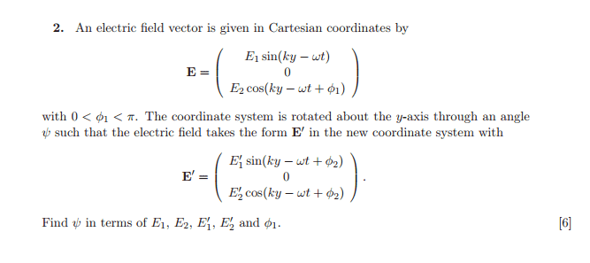

Suppose an E-field is rotated by angle ø2. Express ø2 in terms of:
I used the rotation matrix, and compared LHS and RHS but it led to nowhere:
[tex] E'= RE [/tex]
[tex]\left ( \begin{array}{cc}
E_1' sin (ky-ωt+ø_2) \\
0 \\
E_2' cos (ky-ωt+ø_2)
\end{array}
\right )
cos ø_2 & 0 & sin ø_2 \\
0 & 1 & 0 \\
-sin ø_2 & 0 & cos ø_2
\end {array}
\right)
E_1 sin (ky-ωt) \\
0 \\
E_2 cos (ky-ωt+ø_1)
\end{array}
\right )[/tex]
It's a very badly post question, because it's not defined around which axis you should rotate. I guess it's the [itex]y[/itex] axis from what's in the white box. You should send the complete question or ask those who have posed the problem for clarification ;-)).
This said, the behavior of the electric field under rotations is very well defined, because [itex]\vec{E}[/itex] is a vector field (in the sense of 3D Euclidean space),
[tex]\vec{E}'(t,\vec{r}')=\hat{R} \vec{E}(t,\vec{r})=\hat{R} \vec{E}(t,\hat{R}^{-1} \vec{r}').[/tex]
The emphasis is on field, because you have to consider both the field value and the spatial argument in the transformation rule!
Sorry, I don't really get what you mean. Do you mean a matrix multiplication: [tex]\vec{E}'(t,\vec{r}')=\hat{R} \vec{E}(t,\vec{r})[/tex] ?
