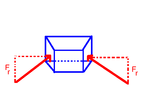

But when I tried to derive the first equation myself I ended up with something else. Here is my attempt to derive it. I am not including the diagram of the container so I request you to imagine the shape of the fluid element while I explain it. Let us assume that the density of the liquid is constant throughout.
As stated above, the variation in pressure with respect to angle in cylindrical co-ordinate system is zero. Hence let us imagine a cylindrical fluid element of radius 'r', thickness 'dr' and height 'dz'. Now we know that the pressure is the same at regions having same elevation and radius. Let the pressure be denoted by 'P'. Now we can do the force balance considering the pressure forces and the centrifugal force.
$$(P+\frac{\partial P}{\partial r}\frac{dr}{2})2\pi(r+\frac{dr}{2})dz - (P-\frac{\partial P}{\partial r}\frac{dr}{2})2\pi(r-\frac{dr}{2})dz = 2\pi r dr dz \rho r \omega^2$$
On simplifying this we get,
$$P dr+r\frac{\partial P}{\partial r} dr = \rho r^2 \omega^2 dr$$
Further simplification yields,
$$P+r\frac{\partial P}{\partial r} = \rho r^2 \omega^2$$
Finally this simplifies to
$$\frac{\partial}{\partial r}(Pr) = \rho r^2 \omega^2$$
This final result that we get has considerable difference from the one that is given in the book.
Please help me to find out where I have gone wrong in the derivation.

I haven't checked your work in detail, but your term on the right, 2πρrdrdzω2 should have an extra factor of r.
One r comes from the centripetal acceleration (rω2) and one r comes from the volume (2πrdrdz)
Also you don't need to work from the middle and move dr/2 in both directions, you can just start from one side and move dr to the other side.
Your ("midpoint") method would be more accurate if we were working with finite approximations, but in the limit of dr→0 the result is the same.
Edit:
It isn't correct to consider an entire cylindrical shell of liquid. You have to remember you are dealing with vectors (dA and dF) and they cancel out when you consider an entire cylinder (the net force needed for a cylinder to rotate is zero...)
Instead just work with an element of liquid which has a surface area dA which is small enough that it is approximately flat (so none of the force from the pressure cancels out).

The error of your derivation is related to something you said regarding a rigid cylinder. In the case of a rigid cylinder, there is a tensile hoop stress. In the case of your fluid, there is compressive stress by pressure in the hoop direction. You omitted that from your derivation. When you include it, you will find that it exactly cancels the P/r term.

It is not the same :wink: You need to be careful: what is the shape of this element? Is the only radial pressure coming from those two sides?
This is what you are doing ##(P+dP)(A+dA)-PA = rω^2ρAdr## which leads to ##\frac{dP}{dr}=ρrω^2-\frac{P}{A}\frac{dA}{dr}## with the right-most term equal to P/r
But the left side of this equation should have another term (which causes the P/r to vanish). This term comes from the other two sides of the element:
See, when you take the two sides to have different areas, this necessarily implies there is another component of radial force on the other sides.
There is a simple way to take account of these sides, which will give you the right answer.
Or you can just consider an element which has two equal sides, so that the force on the other sides vanishes: ##(P+dP)A-PA=rω^2ρAdr \Rightarrow \frac{dP}{dr}=ρrω^2##

Thank you Nathaneal for the help. The basic error was in considering the entire cylindrical shell instead of the tiny element. Further by including the compressive stresses in the circumferential direction as suggested by chestermiller we get the exact same result as given in the textbook.
