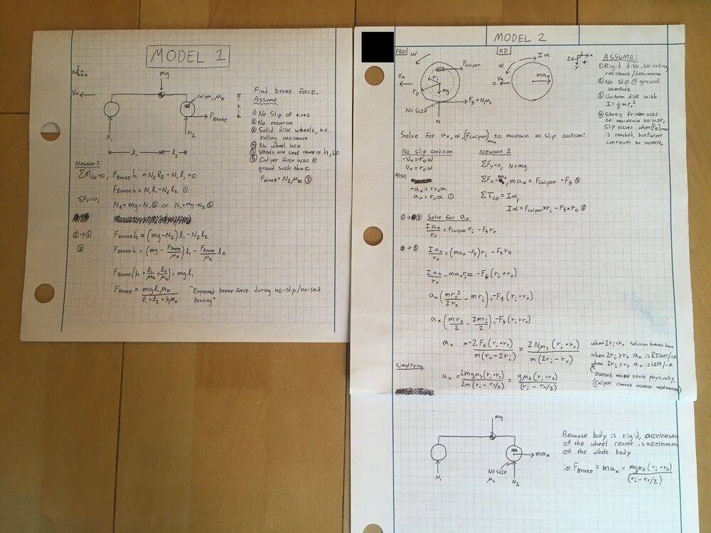

TL;DR Summary
Uncertainty about validity of 2 different models
I am a junior engineer tasked with modeling the dynamics of a small research UAV after landing. The UAV has 3 tires, 1 on the nose landing gear and 2 on the rear landing gear. The rear tires are equipped with disc brake calipers.
My coworker has explained that the simplified model (MODEL 1 below) is sufficient to find the horizontal deceleration on the aircraft CG caused by the brake calipers. This model assumes the tire radii are negligible and the caliper force acts at approximately the same location as the tire-runway interface. The coefficient of kinetic friction (μ_k) between the caliper and disc is then approximated from a textbook which plots μ_k decreasing with velocity.
Uncomfortable with the small radius approximation, I have attempted to model the wheel as a solid disk to find the horizontal acceleration of the wheel center (MODEL 2 below). Assuming the chassis is a rigid body, the horizontal acceleration of the wheel axle should give the acceleration of the whole aircraft.
I have difficulty understanding if either approach is correct and particularly the role and location of the frictional forces.
In MODEL 1, the maximum brake force is found directly from only the normal force and μ_k, but I don't understand why. The no slip condition and small radius approximation acting simultaneously are preventing me from understanding this clearly.
I can accept the approximation that if the tire radius is negligible, the kinetic caliper friction can be viewed as acting at the same point as the static tire friction. I also recognize that the brake force exerted by the calipers decreases at higher speeds (ie. the brake force should be a function of the kinetic friction coefficient of the caliper-disc interface).
Any help and corrections that you could provide to better intuit the physics at play would be greatly appreciated. Thank you very much for reading.

Indeed the points you made are accurate. The lift, thrust, rolling resistance, drag and brake force are vector summed to estimate the total acceleration of the aircraft. My misunderstanding is specific to the calculation of the brake force.
The following questions in particular continue to bother me:
1. In MODEL 1, the brake force is drawn as acting at the tire-runway contact because the wheel is assumed to be small (wheel is a point). If the tire size is non-negligible, shouldn't this frictional force be acting at the caliper-pad contact point? In that case, won't the moment arm h be shorter?
2. In MODEL 2, I have drawn a static friction force at the tire-runway contact. I have assumed this static friction is necessary to maintain the no slip condition of the tire and when it is exceeded the tire will slide. Is it appropriate to include it in the FBD as shown? Is a static friction force really necessary to maintain the no slip condition?
MODEL 2 seems to give unrealistic brake force values. I'm tempted to redraw the FBD with only the caliper force contributing to the total braking force. If MODEL 2's FBD is redrawn with the caliper force only then clearly it approaches MODEL 1's results. If a static friction force is not necessary to maintain no-slip, then unfortunately I also don't understand when it should or shouldn't be drawn.
The tire radius is NOT negligible. The torque from the caliper is the same as the torque from the tire, but the forces are not ... unless you have this set up:

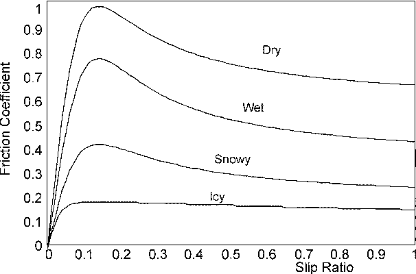

The deceleration is related to the tire-pavement friction force. There is a maximum friction coefficient that can be found in textbooks or with tests. It doesn't matter how this force is created to calculate the deceleration. (Even though it is always at some amount of slip. Usually at around 10-20% slip.)
To design the brake system, you need to find how much torque it has to produce to create that tire maximum friction force (and how much energy it has to dissipate as well). That's it.

What I tried to say previously (sorry, English is not my native language) is that the weakest link in the mechanism of brakes is the contact patches of the tires, which greatly depend on the normal force on each tire, which depends on the dynamics of landing, like remaining wing lift, oscillations due to adjustments on roll and yaw, distribution of weight, bounce backs into the air, as well as nose down-tail up effect of brake application for maximum deceleration.
It is not until the full weight of the airplane is pushing the tires against the pavement and the front tire has touched down that the pilot can fully apply brakes.
By then, a good portion of available runway has been wasted and the rubber is pushed to the limits: there is no much safety factor there, especially when rain or snow are present.

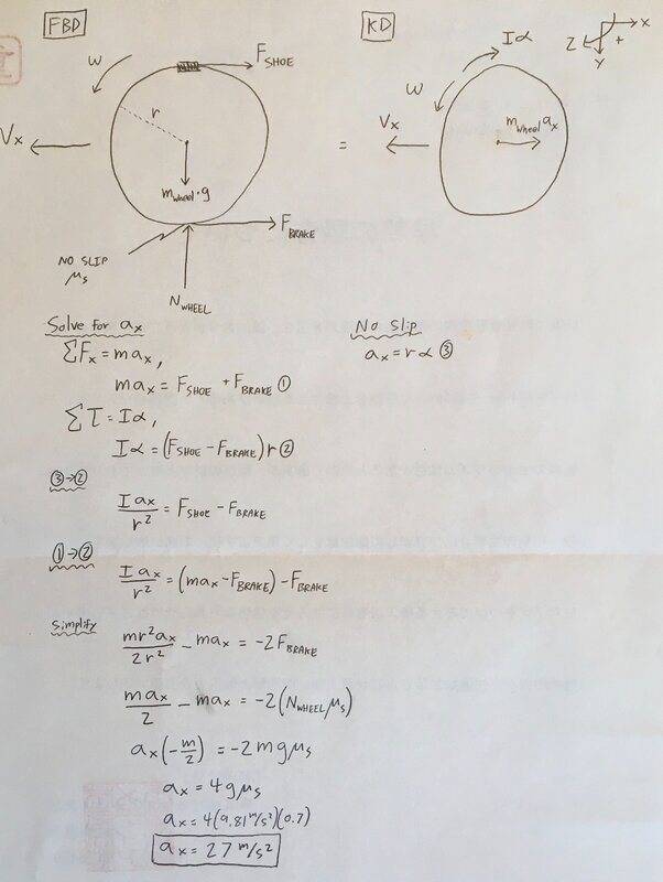

Understood. So considering the whole vehicle braking under no slip, ##F_{brake}## is a static friction force which depends only on the pavement-tire slip ratio as shown in the chart above. In the case of the whole vehicle, the caliper friction force is internal so it is not drawn.
One thing I do not understand with this simplified model is that the brake force is generated by the caliper's kinetic friction which depends on velocity, heat etc. but ##F_{brake}## does not directly depend on velocity, only the slip ratio of the tire. If the wheels are approximately not slipping (eg. slip ratio = 0.1) does that mean the brake force is constant at every speed? Is that really correct?

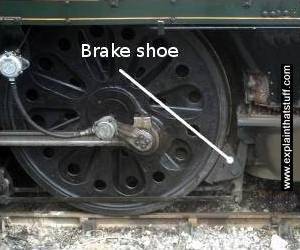

In trying to model only the wheel as a solid disk (like the train brake shoe configuration) I get what looks like unreasonable acceleration (below). Can you point out where I'm going wrong?

Also, in trying to model only the wheel as a solid disk (like the train brake shoe configuration) I get what looks like unreasonable acceleration (below). Can you point out where I'm going wrong?
##F_{shoe}## is an internal force, forget about it.
$$m_e a = F_{brake}$$
##m_e## is equal to the total mass of the vehicle ##m## PLUS the inertia of the wheel ##I_w## converted to an equivalent mass ##m_{Iw}##, acting at the wheel radius ##r##, at the vehicle acceleration ##a##:
$$m_{Iw}ar = I_w\alpha = \frac{m_w r^2}{2}\frac{a}{r}$$
$$m_{Iw} = \frac{m_w}{2}$$
Therefore:
$$(m + m_{Iw}) a = F_{brake}$$
$$\left(m + \frac{m_w}{2}\right) a = \mu mg$$
Or:
$$a = \frac{\mu g}{\left(1 + \frac{m_w}{2m}\right)}$$
And in the case you presented, the mass of the wheel ##m_w## is the same as the mass of the vehicle ##m##, so ##a = \frac{2}{3} \mu g##.

I see. I understand now the reasoning behind excluding the brake caliper force from the entire system FBD. It looks like this was the major gap in my understanding of my coworker’s model. Thank you very much for helping to clarify that point and for reminding me about the Coulomb friction model's assumption.
Unfortunately, I don't agree that the brake shoe can be excluded from the FBD of the disk. It acts directly on the body so ignoring it is very uncomfortable, plus we know there must be a clockwise angular acceleration to decelerate the disk. An FBD with only the pavement friction force can not provide this clockwise angular deceleration. After some thought and a couple days I think I've found my error.
In the FBD I drew, the direction of the brake caliper / shoe friction force I drew is incorrect. The direction pointing to the right is arbitrary. If I drew it in a different location the sense would change, always apposing the angular velocity. In fact, if the brake caliper was a donut shape, the friction force would affect the disk the same way but would have no linear component.
The brake shoe or caliper can only provide a deceleration Torque, no linear Force. It does not contribute to the linear acceleration, which is why it can be incorrectly ignored in a model of the disk and the correct linear acceleration will still be produced.
The horizontal acceleration of the center of the wheel in the x direction is related to the angular acceleration by no slip: $$ a_{o} = rα $$ This is why is it tempting but incorrect to say the sum of torques is zero ie. $$ F_{friction}r = τ_{caliper} $$ Impossible, since there would be no change in ω, but correct to say $$ a_{o} = rα $$ to describe the acceleration of the center of the disk.
I'll redraw what I think are the correct FBD and KD when I have a little more time.
Thank you both for your help!
C
Likes Lnewqban
The reality is that your caliper friction force does not come alone. To fully do the analysis including the caliper force on the disk, you must also include the same caliper force acting on the body (Newton's third law). This is how your caliper torque will be canceled. Then the body will interact with ground as well and your system will be closed.
The problem with your FBD is that the vehicle's body is missing. A caliper alone on a wheel will just turn with the wheel if it is clamped. Something must restrain it from moving. Add the body to your FBD and consider all forces and moments acting on each component, but consider also the constraints also (ex.: the linear accelerations of the body and wheel are the same in direction and magnitude, even though one's acting on the body mass and the other on the wheel mass).
Doing it the way I did, I just bypassed the internal forces that cancel each other out, and ended up with the overall result for the whole vehicle. The important thing to understand is that no matter how it works internally, it cannot produce more than what the overall system can provide. Obviously, if you design a brake system, you will have to analyze the internal forces at some point.
