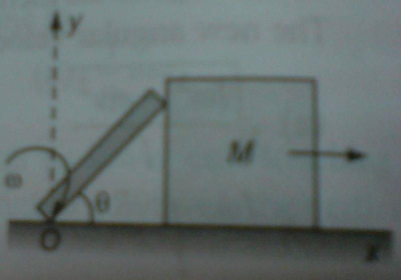

A uniform rod of mass m and length l is pivoted at point O. The rod is initially in vertical position and touching a block of mass M which is at rest on a horizontal surface. The rod is given a slight jerk and it starts rotating about point O. This causes the block to move forward. The rod loses contact with the block at θ = 30°. All surfaces are smooth.
1. The value of M/m?
2. The velocity of block when the rod loses contact with the block?
3. The acceleration of center of mass of rod, when it loses contact with the block?
4. The hinge reaction at O on the rod when it loses contact with the block?
Ans 1) 4:3
2)√(3gl)/4
3) (3g)/4
4)(mg/4)j
The speed of the tip of the rod in horizontal direction is same as that of the block .
Let V be the speed of the block when rod loses contact with block.
So,Horizontal speed of the tip of the rod = V
Component of speed perpendicular to length of the rod =[itex]V_{\bot}[/itex] = VSin30°=V/2
Angular speed of the rod at the instant block leaves contact with the rod =[itex]\frac{V_{\bot}}{l}[/itex] = [itex]\frac{V}{2l}[/itex]
Applying Conservation of Energy ,
Loss in Potential Energy of Rod = Gain in Rotational Kinetic Energy of Rod + Gain in KE of Block
[itex]\frac{Mgl}{2}(1-Sin60°) = \frac{1}{2}\frac{ml^2}{3}(ω ^2) +\frac{1}{2}MV^2 [/itex]
[itex]\frac{Mgl}{2}(1-Sin60°) = \frac{1}{2}\frac{ml^2}{3}\frac{V ^2}{4l^2} +\frac{1}{2}MV^2 [/itex]
[itex]\frac{Mgl}{4} = \frac{mV^2}{24} +\frac{1}{2}MV^2 [/itex]
Is my approach correct ? Now ,how am I supposed to proceed further ? one more equation is required to solve the problem ...
No, that's backwards. Which way is the tip of the rod moving?
Not sin(60), I think. But I see that you actually used the right value below.
Maybe energy alone won't cut it, and you need to use forces and accelerations. This could be because the energy equation fails to capture the fact that the tip of the rod and the block have moved the same horizontal distance in the same time.

Tanya Sharma said:
I have thought in terms of forces...but really haven't been able to relate things...
Don't worry about the force at the hinge. The critical statement we have to turn into an equation is that the normal force vanishes. In terms of the angular speed and acceleration, what is the acceleration of the block (be very careful with that one), the normal force on the block, and the torque on the rod?
Net torque on the rod about pivot =[itex]mg\frac{l}{2}cosθ -Nlsinθ[/itex]
where θ is the angle which rod makes with the horizontal
The acceleration of the block is a=N/M where N is the normal contact force between block and the rod
Since ,ωl/2=V
Therefore , differentiating above we get,
αl/2=a
Right, so relate that to the angular acceleration of the rod, relate N to the linear acceleration of the block, and relate that acceleration back to the angular acceleration and velocity of the rod.

Tanya Sharma said:
I don't know how to work with polar coordinates...I would be grateful if you could tell me the polar coordinate formula for acceleration of the tip.
I expect you do, but maybe not with that terminology. If the rod were rotating at constant angular speed it would nonetheless have an acceleration, right? What's the formula for that and in which direction does it operate? Since the angular speed is not constant it has another linear acceleration. What's the formula and direction of that?

Yes, you can also write that N= -LM(cosθ ω2+sinθ α).And what is N at the moment when the rod and block lose contact?
ehild
N=0 at this moment.Putting N=0 ,we get
ω2 =-αtanθ
now Iα = mg(l/2)cosθ at the moment rod loses contact .
I get correct values for first three parts .:biggrin:
Now, how to deal with last part where we have to calculate hinge force ??

The force at the hinge can be determined if you know the acceleration of the centre of mass, which is the sum of all forces divided by m.
What is the acceleration of the COM at angle θ =30°?
ehild
acom=3g/4.I have calculated it from the radial and tangential components.
Is there another way of calculating it??
What is the direction of acom?
You can get the components of the acceleration of COM also from the acceleration of the tip.
acomx=0.5d2x/dt2, acomy=0.5d2y/dt2
ehild

Very well! So you got the correct result that the reaction force is mg/4 at the hinge upward.
You would get the same from the x,y components of acceleration. I like this method, as I usually get confused with the radial and tangential components.
The coordinates of the COM of a homogeneous rod with the ends at (x1,y1) and (x2,y2) are Xcom=(x1+x2)/2, Ycom=(y1+y2)/2. (x1,y1)=(0,0), and (x2,y2)=(x,y) here, so Xcom=x/2, Ycom=y/2.
You derived the x component of acceleration already, the same has to be done with the y component.
y=Lsin(θ) y'=Lcos(θ) θ',
y''= L(-sin(θ)θ'2+cos(θ)θ")=L(-sinθω2+cos(θ)ω')
When loosing contact, y"=L(-1/2 ω2+√3/2 ω')
From the condition that the x component of acceleration is zero, you have got that
ω'=-√3 ω2 and ω2=3g/4L, therefore y"=-3g/2,
and Ycom"=-3g/4.
