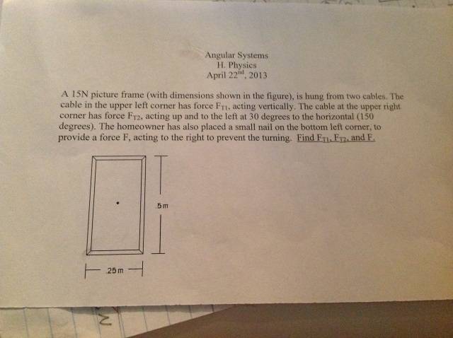

In summary, the problem involves finding the forces F, Ft1, and Ft2 given the equations Fx = Ft2 cos(θ) - F = 0, Fy = Ft2 sin(θ) + Ft1 - Fg = 0, and -FgDg - Ft2D1x cos(θ) + Ft2D1y sin(θ) = 0. The attempt at a solution involved plugging in the given information, but the correct answer was not obtained. There may be an error in the distances used in the equations. The suggestion was made to calculate torque from the nail and use the fact that the picture can only rotate along the nail.
Repolar
Answers were told to us to be
F = 2.91 N
Ft1 = 13.32 N
Ft2 = 3.36 N
Torque equation
I plugged in all of the information i had but did not get the right answer. I think my distances may be off but i cannot seem to get to those answers.
That doesn't look right. The angle is to the horizontal, so cos(theta) should be giving a horizontal force component. That needs to be multiplied by a vertical distance. Pls post your working in detail.
why not calculate torque from the nail then rotation is 0 and the picture can only rotate along the nail then FT1 being parallel to the line of action offers no torque only mg is balanced by FT2 the by that u can find the others
