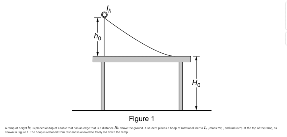

A ramp is set up on top of a table. An object is supposed to roll freely down the ramp off the table and have a horizontal displacement. Two objects are used in the same setup. One is a hollow hoop and another is a solid disk. The rotational inertia of the disk is higher than the rotational inertia of the hoop, their mass and radii are the same. Which object will have the larger horizontal displacement?
Krotational=1/2lw^2 Ktranslational=1/2mv^2 Ug=mgh Ihoop=MR^2 Idisk=1/2MR^2 tnet=I(alpha)
I know that a hoop should have a higher rotational inertia than a solid disk because its mass is distributed further from the axis of rotation. What I don't understand is how a disk of the same mass and radius can have a higher rotational inertia. If the objects roll freely their axes of rotation should be about their center so the equations I=MR^2 for the hoop and I=1/2MR^2 for the disk should apply. How can a disk somehow have a higher rotational inertia? I know that the disk should travel further than the hoop but this suggests the opposite.

The question itself says that Id > Ih where Id is the rotational inertia of the disk and Ih is the rotational inertial of the hoop.

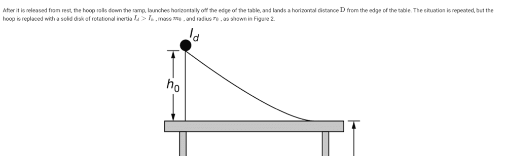

Did the problem statement actually state that the two objects have the same mass and radius? If not, then the disk could have a greater rotational than the hoop. I'm just looking at
The mass and radius of both the hoop and the disk are defined as m0 and r0 respectively, so maybe the question is giving me false information so I catch on to the false physics at work?
OK. So, there is more to the problem statement than what is given in the figure that you posted in post #7.
Even if the disk had a greater mass and/or radius so that it had the greater rotational inertia, it would still travel the greater horizontal distance. So, it's not really important whether or not they have the same radius and mass.
Yes, this is the problem describing the hoop. It just defines the mass and radius with the same variables and describes the ramp situation.
Likes TSny
So even though the disk has greater inertia, it will still have the larger horizontal displacement? Is there a concept that I'm missing or overlooked here?
OK, thanks. Yes, as @hutchphd said, there is an inconsistency in the problem statement. You were right to be puzzled about how ##I_d## could be greater than ##I_h## if the objects have the same mass and radius.
