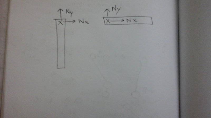

okay...I understand your explanation. ..And I am sorry...let me clarify the second question...what I was asking was why are there two components of hinge reactions.. (as shown in the attached file a rod is fixed to a hinge which in turn is attached to a wall...) So in this situation what role do the horizontal and vertical components play..? This is what I wanted to know..Thank you...

Also..In the second figure (refer attached file) I am not sure whether the horizontal component of hinge reaction will be in a direction along the rod(as I have shown it in the picture) or in the opposite direction?

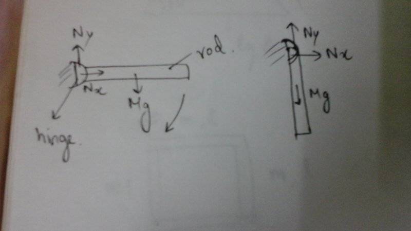

But I am no longer talking about the door...Here is a single hinge pinned to a wall about which a rod rotates...What do the two components of reaction stand for..?

How about this? Does this make things clear...?

The best I can deduce from this is that you see what is on the right, and you need a function to express the force on the hinge in various positions, for example the image on the left that you drew the rod wouldn't fall straight down, but rather swing down to the picture on the right where Nx=0

You should describe the direction of the forces you call "normal reactions". What are they normal to? If possible post a diagram or give a link to one.
I see the diagram now. In a 2-D problem there will be a 2-D net force vector exerted upon the hinge. A force in 2-D can be broken into two perpendicular components. The direction of these components has been chosen for convenience. The fact there are two components just tells you that the total force on the door is the sum of these components.
