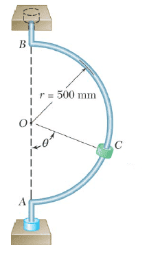

In summary, a 350-g collar C is sliding on a semicircular rod that is rotating at a constant rate of 7.5 rad/s around the vertical axis AB. The coefficients of friction are μs = 0.25 and μk = 0.20. The collar experiences two forces, rotational and gravitational, and the normal acceleration can be calculated using the equations for tangent velocity and normal acceleration. However, a computer program indicates that the solution is incorrect.
Enginseer
A small 350-g collar C can slide on a semicircular rod which is made to rotate about the vertical AB at a constant rate of 7.5 rad/s. The coefficients of friction are μs = 0.25 and μk = 0.20.
Tangent Velocity= Radians*radius
Normal acceleration an= Vt^2/radius
Basically the collar has two forces acting on it. The rotational force and the gravitational force. I used the y-axis for the force components parallel/opposite to the normal force and multiplied the normal force by the kinetic friction which should have given me the frictional force. But the computer program I'm using (Mcgraw hill) says my answer is wrong.
