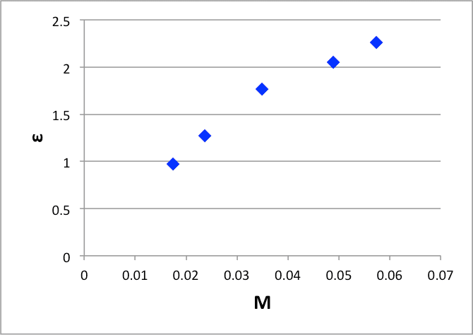

I have an angular acceleration and torque graph.
I know it should be a straight line between the points, but my question is, if you extend the line toward the angular acceleration, why it doesn't go to the zero point? It is about 0,6.
I have thought that there is some other forces that doesn't let the acceleration to be so low. If there is no acceleration, then how there can be any torque? The torque is what's making the accelration as I have learned.

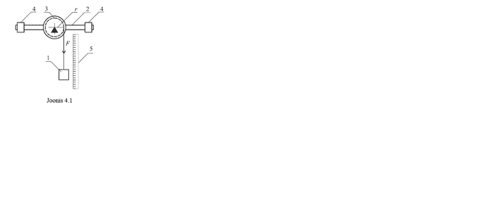

Is the spool upon which the cord is wrapped freewheeling or powered?

Kristjan, was this graph made from data collected in an experiment? If so, can you describe the setup?
Yes, it is data from an experiment.
I had to check the constitution of the rotational dynamics. I put on weights and then the machine showed me the time. After that I had to look how far up weights went. Just like in that picture. After that, using the formulas, I calculated torque, acceleration and also moment of inertia.

The weights were going up, not down?
Yes, they went up.
Kristjan Tervonen said:
Yes, they went up.
Then you need to explain more about the set-up. What is driving the weights up? Please explain everything in the diagram.
The plot by @Kristjan Tervonen bothers me. The values on the horizontal (M) axis are not spaced equally apart. Unless the abscissa is linear, it is not obvious whether there is a linear dependence in the plotted data. Assuming that the numbers on the abscissa are the actual values of M, not tickmark labels, and that the labels next to the data points are the corresponding values of ε, I replotted the data (see below). Depending on the error bars of the experiment, the result could be construed as a straight line.

I think I know the answer now. Torque's values are less lower. So in the reality the graph is very narrow and should then go to the zero point.

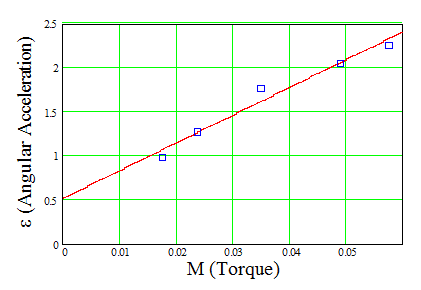

I don't think that playing with the graph proportions is a valid way to make the issue go away. The differences in measured values for angular acceleration is smaller than the zero offset value, so it shouldn't be a precision issue. Here's a best-fit line drawn through the given data:
The offset might be attributable to a calibration issue (a systematic error) if the device or method for measuring the angular acceleration has an uncorrected bias.

Or, considering that the first few points do project a reasonably straight line through the origin, some effect is inhibiting or underestimating the acceleration at the higher torques.
