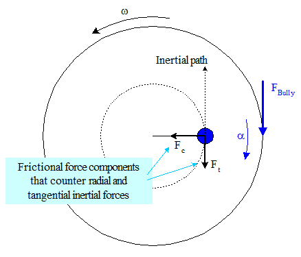

A child is at a playground, and chooses to try the spinning disc (see figure). The radius of the disc is 2.00 m, and the coefficient of static friction between child-surface and disc-surface is μs = 0.350.
In the following questions, you must provide algebraic equations as well as final numbers.
a) If the child sits 1.50 m from the centre, how fast can the spinning disc turn, without her slipping off?
b) The evil big brother now spins the disc with ω = 2.00 rad/s. At what distance from the centre of the disc should the kid sit, to avoid falling off?
Having safely moved to the radius 0.500 m, the child starts complaining, becau- se she cannot get off the ride. The evil big brother decides to stop the rotating disc, by providing a constant tangential force.
c) How quickly can he stop the disc, without her sliding in any direction (neither forwards, backwards, inwards or outwards)?
(possibly)[/B]
1. m⋅ν2/r (centrifugal force)
2. ω = ν/r (angular velocity)
3. a = -ν2/r (accelration)
3. F = ma (Newton Law)
Relevant information:
r = 2.00m (radius of the disc)
μs = 0.350 (static friction)
Fs = μs⋅mg
ra = 1.50m (distance from centre - in a)
My attempt:
2/r = μsmg
μs = νmax2/rg
vmax = √μsrg
vmax = √0.350⋅1.50m⋅9.80m/s2 = 2.27 rad/s

In (a) the child sits at a radius of 1.50 m, so the centripetal force required will correspond to that radius. The speed of the disk should be specified in terms of rotational speed: radians per second (ω).
You may find it easier to work in angular quantities rather than translating back and forth to linear ones. Centripetal force, for example, is given by mω2r, bypassing the need to convert to linear speed to use mv2/r.

The question states that you're looking for the minimum time to stop the rotation. Just assume that there's some angular acceleration α. What is the maximum value that α can have so that the girl doesn't slide? Once you have a value for α you can work on finding the time to stop.
But which equation do I use to find a?
You're looking for the net force that the girl experiences. You've got centripetal acceleration and tangential acceleration operating, and friction force to oppose the resultant. Draw a diagram.
ac is towards the centre, and at and the friction is in the opposite direction of each other (and both perpendicular to ac)?
Do I take the sum of those forces?
so ΣF = ac + at -Fs ?
The friction force counters the tendency of the girl to continue moving in a straight line path (tangentially). This tendency is due to inertia.
To accomplish this, the friction force must supply a component to provide the required centripetal acceleration (radial) as well as one to counter the tangential acceleration due to the disk being slowed. Being components at right angles we naturally have a vector sum for the total friction required.
So you need to first write expressions for the tangential force that the girl experiences and the centripetal force that she experiences. Then sum them appropriately so that the sum can be compared to the maximal static friction force.

You have an assumed angular acceleration ##\alpha##. How is the instantaneous linear acceleration related to angular acceleration? What mass is being accelerated? So what's the force?
Instantaneous linear acc. = angular acc * radius ?
The spinning wheel is being accelerated? With the mass of gravity and the child?
Ft = mg⋅r⋅a ?
Ft = mg⋅r⋅a ?
Don't look at gravity yet. That will come in when you look at the friction force itself. For now deal with the radial and tangential forces which are not vertical and do not involve gravity.
Only the mass of the child is of interest here. We don't know how massive the disk is or what its moment of inertia might be. That's the Bully's problem to deal with as he musters enough force to cause some acceleration ##\alpha##.
The disk is accelerating (slowing down) and for the child to remain in the same location on it she must slow down too. So friction provides the force between the disk and her to accomplish this. By Newton's 3rd law the force accelerating her is matched by the so-called inertial force of her mass resisting acceleration.

You definitely want to sum the components to find the total force required to keep the child pinned in place on the disk. How will you sum these components?

Remember, you're dealing with vector components here. How do you sum vector components to find the magnitude of the vector?
