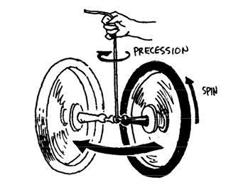

So in the image, we know that the wheel will want to go down because of gravity. Hypothetically if gravity brought the wheel down, would it not be still spinning clockwise at the same rotational speeds? I don't see why not, looking at just Newtons laws.
But looking at the directions of angular momentum and torque vectors would contradict my example.

Well, gravity will try to bring the wheel down. The axle will probably create some friction on the wheel, affecting the rotational speeds, but not the direction. But let's assume frictionless axle.
the parts the the wheel going up will be slowed down and the parts of the wheel going down will be sped up. So its like a bead constrained in a vertical loop that will go on forever.
So the individial motion of the points are like a bunch of beads moving counterclockwise on a loop. And if I drop the loop of beads, the loop will fall. And the beads will revert back to constant cetrepetal accerlation, if at the horizontal position. It's probably somewhere in between since the loop will twist in freefall.Now the wheel is attached to a rope. So you might say its different. But even if the rope went taut, canceling out with the weight of the axle, if the axle is frictionless, there is no reason why the axle will spin around in the horizontal plane.
The only way is if the wheel exerts a force on the axle in the horizontal direction. Which doesn't make sense because the rope and gravity only pulls in the vertical, so any response contact force on the axle would be up or down. Not sideways. Even if we only require constant tangental speed for horizontal movement of the axile, there at least needs to be an initial sideways force tangentaly to change bring the axle out the its rest state.

Oh I see. That makes sense. So in the first video, the orbit got tilted.
So the wheel(i.e orbit) when looked from the top down will constantly tilt in the counter clockwise direction. But in order for this to happen, the twisting force from gravity must always be perpendicular to the path of orbit. Which make sense because once the orbit tilts, the axle tilts with it, maintaining the twisting force from gravity as always perpendicular.
The "twisting force" (corresponding to the green arrows in the first video) comes from the support force, not from gravity. It is transmitted to the outer masses via the spokes (which have different tension depending on the side).
