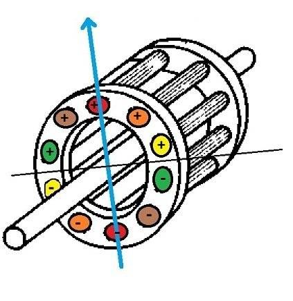

As Babadaq said in post 6, how you make flux rotate is immaterial, it's relative motion between flux and rotor bars that makes torque.
At some instant we have flux stator flux B in blue, and rotor is rotating relative to it CCW .
Velocity of each bar relative to B changes from parallel to perpendicular back to parallel twice per revolution
is it clear that QVcrossB varies sinusoidally ?
Re your old thread....
I was starting to calculate current in each bar and resultant torque
assigned dimensions that included pi so as to make the expressions simple as possible and produce round numbers.
here's how far i got
Let's start here
Blue stator flux arrow rotates CCW at 3600 RPM, 60 hz
and for my thought experiment i'll give rotor these dimensions:
12.532 inch (1/pi meter) diameter by 19.685 inches (1/2 meter) long
Squirrel cage rotates CCW at 3540 RPM, 59 hz, slip = 60 RPM = 1.67%
i'll ride along with rotor and watch flux arrow pull ahead of me one rotation per second
motion of flux relative to squirrel cage is 1 revolution per second, counter clockwise
And i'll set flux density at 1 Tesla , which over cross sectional area of the rotor( L X W = 0.5 X 1/pi) is 1/2pi Webers.
Any pair of rotor bars forms a loop . The flux encircled by that loop varies siusoidally from -1/2pi to +1/2pi webers as B sweeps ahead of the rotor at 1 hz
so flux phi in red rotor loop = 1/2pi X sin(2pi t ), t = time in seconds
so flux = 1/2pi X sin(2pi t )
and voltage induced at any instant should be
2pi/2pi picos(2pit) = 1 volt peak at 1 hz
alternately, in any bar
e=blvsin(angle between velocity and B)
l was given as 1/2 meter,
radius = 1/2pi, so at 1 rps velocity = 2pir = 2pi/2pi = 1 meter /sec
each red bar has blv = 1T X 1/2 meter X 1m/sec = 1/2 volt, two bars make a loop agreeing with one volt by flux linkage method.
red bars e=blvsin90, =1 volt, top bar's current will flow out of page bottom one into page as shown by polarity sign
orange bars e=blvsin54 = 0.81
yellow bars e=blvsin18 = 0.31
green bars e=blvsin-18 = -0.31
brown bars e=blvsin-54 = -0.81
Next step is to estimate Land R of rotor turns and figure bar current, then torque on each set of bars

right there's the key to understanding the motor ...
think very simply for a moment
In my primitive picture up above
i aligned flux with red bars
were there any current in the red bars at that instant , red bar's flux would be perpendicular to blue flux and there'd be torque.
If red bars have zero resistance then current in them lags voltage in them by 90 degrees and is zero at instant shown, so there's no torque from red bars.
If red bars have some resistance then current lags by less than 90 degrees so there is torque from the red bars.
That's why adding resistance in the rotor gives more starting torque
not to mention it reduces starting current because the rotor at standstill looks less like a shorted secondary.

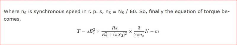

This scary looking equation from http://www.electrical4u.com/torque-equation-of-three-phase-induction-motor/
(subscript 2 meaning in the rotor )
agrees with intuition
at any slip s
As rotor resistance approaches zero R2 in numerator drives the fraction to zero , hence low starting torque of low slip motors with their low resistance rotors.
As rotor resistance approaches infinity R22 in denominator takes over again driving the fraction to zero ,
and in between, s terms in both numerator and denominator shape the speed-torque curve.
That formula in a spreadsheet where you can vary rotor R and X and plot against s with just a keystroke would be fun.
