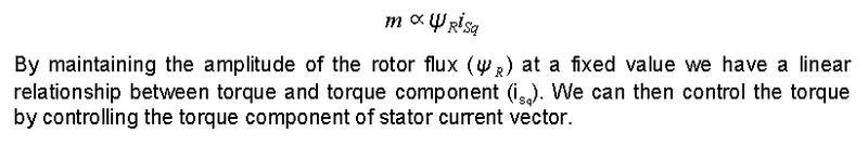

This is one of the big confusions i have. When rotor magnetic field is 90 degrees with respect to stator magnetic field we get maximum torque. In field oriented control the a, b, c axis is converted to d and q axis. So making d axis to 0 and q axis to torque and running through pi loop does automatically the 90 angle differnce? Please help.
See around minutes 13 and 40.
The PI loop just drives measured current to desired amplitude.
