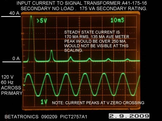

great pictures of lamp inrush too, at
http://www.beta-a2.com/EE-photos.html
Observe he got 40 amps inrush into a ~1.5 amp transformer., 27 X rated current..
Also observe current peaked well after sinewave voltage peak.

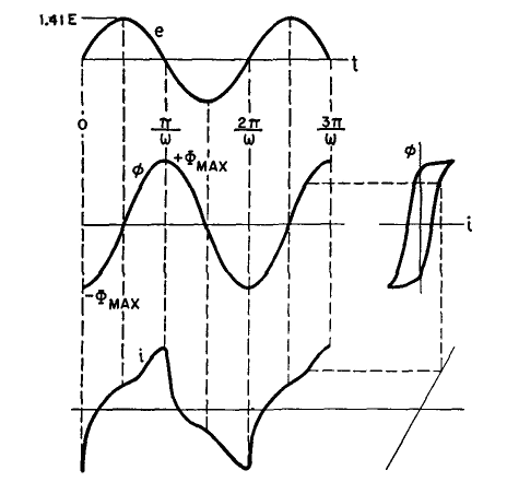

What is going on is this:
SInce e=ndΦ/dt
Φ=(1/n) ∫edt
Aha ! voltage is positive for the whole first half-cycle
so flux must have positive slope for that half cycle, that's what integration does
but flux started from zero not negative peak like it does in steady state operation
and the core saturated .
That repeats for subsequent several cycles, and you'll find it well described in numerous places.
Observe once you reach steady state, at zero volts flux is at negative peak.
but if both start from zero you'll push flux up past the B-H knee so current goes sky high.
http://www.vias.org/eltransformers/lee_electronic_transformers_02_07.html

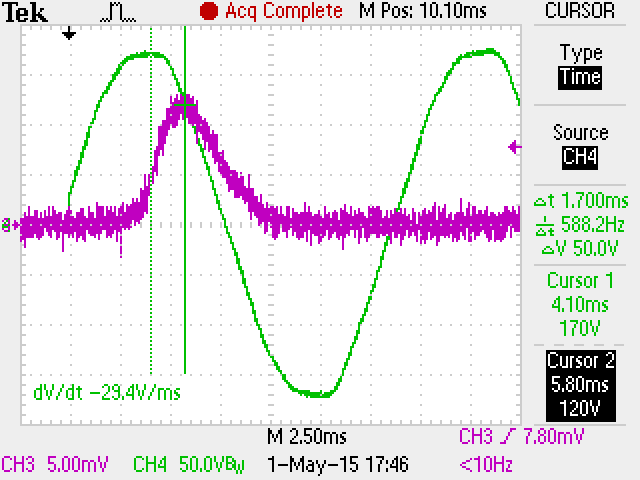

Why do you need to measure the inrush current to the nearest 10 mA? The peak current will be in many amps, and it will be quite variable. If you have read the thread so far you see that the peak current is highly dependent on just when the transformer is connected to the grid voltage.
I hope you know better than to use a sound card scope to make measurements on the grid connection to a transformer.
There is no formula, but you can get a good idea of what the maximum inrush current for a particular transformer would be like this:
Since the inrush current is caused by deep saturation of the core, to a good approximation the only thing limiting the current is the DC resistance of the winding. The peak of the inrush current would then seem to be equal to the peak grid voltage divided by the winding resistance, but this isn't quite right; read on.
I connected a 50 VA transformer (winding resistance of 10 ohms) to the grid through a switch so I could repeatedly turn the excitation on and off until I managed to get a good event, where the connection was made just on the positive going zero crossing of the grid voltage. I also had a 50 amp shunt in series with the winding, and I captured the event on an oscilloscope. This particular scope has isolated inputs so it can be safely used to measure grid voltages and currents. The current is the purple trace at 1 mV per amp; the grid voltage is the green trace. The purple trace is noisy because with a 50 amp shunt, I had to turn the gain of that channel to maximum:
There are two green cursors shown. The left (dotted) one shows the peak grid voltage. Look over on the right side of the image for the "Cursor 1" label: the voltage is 170 V, the peak grid voltage. The right cursor, "Cursor 2", shows a voltage of 120 V when the current reaches its peak value of about 12 amps (purple trace).
The peak current occurs some time after the peak grid voltage. If the peak inrush current had occurred at the time of the peak grid voltage, then the value of that peak current would have been "peak grid voltage/winding resistance = 170/10 = 17 amps".
But since the peak of the inrush current is delayed until sufficient volt-seconds have accrued, which occurs when the grid voltage has passed its positive peak and is decreasing, we might say peak inrush current equals "a certain delayed grid voltage/winding resistance = 120/10 = 12 amps", which is what we see.
The value of the grid voltage when the maximum peak inrush current occurs is coincidentally about equal to the RMS value of the grid voltage. Perhaps it wouldn't be too unreasonable to say that the maximum peak inrush current of a transformer will be about equal to the RMS grid voltage divided by the DC resistance of the transformer winding (the primary usually).
Most of the time when the transformer is connected to the grid, the inrush current won't be this large. But occasionally such a large peak inrush current will occur.
