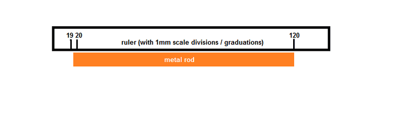

Hello,
I have some questions on uncertainties in measurement:
Say you have a ruler with 1mm graduations, and you are trying to measure the length of a metal rod. One end of the metal rod is at the 120.0mm graduation, and the other is in between the 19 and 20mm graduation, and you approximate its value to be 19.5mm. The uncertainty in these two measurements is half the smallest scale division, and therefore +-0.5mm.
The length of the metal rod = 120.00mm - 19.5mm = 100.5mm
The uncertainty in the length = 0.5mm + 0.5mm = 1mm
However, since the uncertainty in the length is 1mm, would we have to round the length of the metal rod up to 101mm since stating the length of the metal rod as 100.5mm would create false precision? (My textbook states that the length would remain unrounded as 100.5mm +- 1.00mm but I fail to see the reasoning behind it.)
If it does create false precision, then my second question would be:
Would uncertainties such as +- 0.14m, or +-0.32m, or +-0.54m, be contradictory in nature, since they are creating false precision? For example, wouldn't an uncertainty of +-0.14m be contradictory in nature, since it implies a precision of 0.01m, when the measurement, as stated by the uncertainty, is only precise to +-0.14m? Shouldn't an uncertainty of +-0.14m always be rounded upwards to +-0.2m, and all uncertainties in general be rounded to 1sf to avoid false precision?
I know these questions are quite rudimentary but I can't seem to figure them out -- thank you for all your help!

I don't quite understand what you mean with the one end is at 120.0mm and the other is between 19mm and 20mm. If you could clarify this maybe I could help more,but as far as I have understood it I believe you are saying that the metall rod has two uncertantys that sum to 1mm. I think the metall rod has a total uncertainty of 0.5mm and the sum would thus be 0.25+0.25...?!
Hi, I've attached an image here which will hopefully clarify what I mean by how one end of the metal rod is at the 120mm graduation and the other is between 19mm and 20mm:
In order to calculate the length of the metal rod, we have to approximate/estimate where the left end of the metal rod is positioned and where the right end of the metal rod is positioned. The left end of the rod is between 19mm and 20mm, so we approximate it to be 19.5mm, and the right end of the rod is on the 120mm graduation, so we approximate it to be 120mm. Since the smallest scale division is 1mm, the uncertainty is half that, and therefore 0.5mm.
When we subtract one measurement from another (i.e. when we subtract 19.5mm from 120mm) we also have to add the uncertainties, so we add 0.5mm to 0.5mm to get a 1mm uncertainty.
Does this clarify things a bit?

Firstly, thank you for your reply! I just wanted to ask -- wouldn't we have to round the 100.5mm to 101mm, since the uncertainty implies that the measurement is only accurate/precise to the nearest mm -- wouldn't giving the measurement to 1 decimal place create false precision/ suggest that the measurement is precise to 1 decimal place when it is not?

First, note that different textbooks and different instructors do things differently, because these "uncertainty and rounding rules" that rely only on the number of decimal places and significant figures are rather crude. In actual scientific work, we use more precise methods.
Using your original uncertainties, 19.5 ± 0.5 mm and 120.0 ± 0.5 mm, and the simple uncertainty-addition rule, I would calculate the length first as 100.5 ± 1.0 mm. I would then say the uncertainty indicates that the "ones" digit is uncertain, and round it off as 100 ± 1 mm. I use 100 not 101, because the usual rule for rounding when the last digit is 5 is to round the preceding digit to the nearest even number.
So you had the right idea (from my point of view), except that you rounded in the wrong direction. In general, in a final result, I always round the number and its uncertainty to a matching decimal position.
Note that using my "better" rule for adding uncertainties, I get 100.5 ± 0.7 mm. Some instructors don't use the "better" rule in introductory courses, though. If yours doesn't, stick to the simpler rule for now.
Finally, just to confuse you further, I sometimes use two significant figures in the uncertainty, not one, and round the result accordingly. In that case your result would be 100.5 ± 1.0 mm. Note that I wrote the uncertainty as 1.0 (two sig figs), not 1 (one sig fig). This is useful if you expect to use the result in further calculations, to reduce roundoff error.
