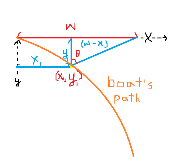

A boater rows across a straight river of constant width ##w##, always heading (i.e., pointing the front of the boat) toward the position on the bank directly opposite the starting point. If the river flows with uniform speed ##v## and if the speed with which the boater can row is also ##v##, find the equation of the path of the boat. How far downstream does the boater finally land? [Hint: if ##x## is the cross-stream position of the boat and ##y## is its downstream position, find an expression for ##dy/dx##. Then solve for ##y(x)##.]
Afterward, please find the trajectory of the boat (##x## vs. ##y## or ##y## vs. ##x##) upon deriving the differential equation.
Refer Below ##\longrightarrow##
First off, to solve for this problem, I relied largely on my below drawn diagram. Forgive the poor work as this was done on a laptop.
Using the above image as reference, I came up with the below equations.
$$\frac{dy}{dx} = \frac{sin \, \theta}{1- cos \, \theta}$$
where ##cos \, \theta = \frac{y}{\sqrt{(w-x)^2 + y^2}}## and ##sin \, \theta = \frac{w-x}{\sqrt{(w-x)^2 + y^2}}##.

Hi,
$$\frac{dy}{dx} = \frac{sin \, \theta}{1- cos \, \theta} $$
How did you derive that ? Your ##\theta## starts out at ##\pi/2## and gradually diminishes to ##0##.
What do you have for the velocities ?
Then from ##dy = v_y dt ## and ##dx = v_x dt\ ,\ \ ## you get ##\displaystyle {dy\over dx} ##

For ##v_y## you write ##v\sin\theta## but the picture clearly shows that should be a cosine. And you omit the contribution from the river flowing (our coordinate system is land-based, isn't it ?) .

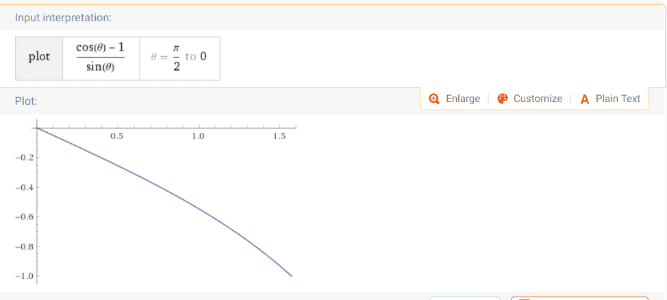

$$\frac{dy}{dx} = \frac{(v \, cos \, \theta - v \, cos(0)) dt}{(v \, sin \, \theta)dt}$$
$$\Rightarrow \frac{v \, cos \, \theta - v \, cos(0)}{v \, sin \, \theta}$$
$$\Rightarrow \frac{v (cos \, \theta - cos(0))}{v \, sin \, \theta}$$
$$\Rightarrow \frac{cos \, \theta -1}{sin \, \theta}$$
I should also note that (as a personal review) the minus sign in the denominator is there simply because as the boat is traveling toward its destination, it is speeding against the river's downstream current.
As a bonus, I did graph out my equation on Wolfram|Alpha and it looks correct in my opinion. Please let me know what you think about my attempted solution. Thank you so much for your assistance!

Athenian said:
Assuming my solution thus far is correct
Not convinced yet :wink: ?
