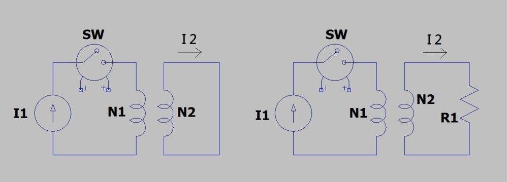

jaus tail said:
But in circuit that we considered, the flux has reached its peak so why would it fall down?
Is it that there is no current so there won't be any flux? But I'm not using that flux anywhere. So where would all the flux go
This is a profound question.
Because the magnetic flux is an energy, it does not disappear in space.
Just consider the following diagram : -
Assuming that the leakage flux between the two coils is zero and the magnetic coupling is 100%, if the initial current in the primary coil is I1, the magnetic flux will not disappear instantaneously when the switch is turned off, which means that the current in the secondary coil, namely I2, will be mystically and instantaneously created at the same moment in order to maintain the same magnetic flux.
In this case, the following equation holds : -
I1*N1 = I2*N2 => I2=I1*N1/N2
where N1 and N2 are the numbers of turns of the primary and secondary coils, respectively
In addition, when the load is zero, namely shorted circuit, I2 will remain unchanged forever (left side of the diagram), and when the load is lossy, I2 will gradually decrease to zero (right hand side of in the diagram)
Likes jaus tail
