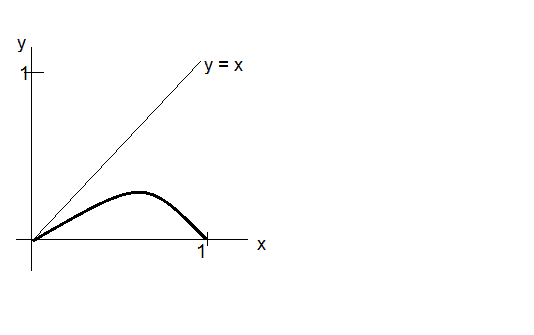

Basically, you're trying to show that every function f that maps the interval [0, 1] into itself must cross through or touch the line y = x at least once. I agree with @tnich that you are asserting that f is injective without showing why this must be true. In fact, for the given conditions, it doesn't have to be true (that f is injective).
In the graph below, f (dark curve) maps [0, 1] into [0, 1]. f is continuous on [0, 1], but neither injective nor surjective.
What could you do with the function ##g(x) \equiv f(x) - x##?
