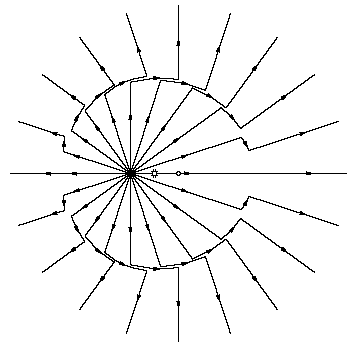

I have never been clear how the equations of radiation for an accelerated particle relate to the intuitive explanation of radiation that is shown in most introductory E&M textbooks (such as the following, which I think is from Purcell):
In the picture, the arrows represent the electric field. For a charged particle at rest, or in uniform motion, the electric field points toward the current location of the particle. If a particle suddenly changes its state of motion (accelerates briefly and then continues at uniform velocity) at time [itex]t[/itex], then at a later time, [itex]t+\delta t[/itex], there will be a spherical shell of radius [itex]c \delta t[/itex] such that inside that shell, the electric field points towards the particle, and outside the shell, the electric field continues to point at where the particle would have been. (Because the information that its state of motion has changed hasn't reached this far.) In the transition between these two regions, the electric field is changing rapidly, and this rapidly changing field (with an associate magnetic field, which is not shown) is a shell of radiation.
With this heuristic way of understanding how acceleration produces radiation, it seems pretty obvious that a charged particle sitting on the surface of a planet will not radiate. Even though the proper acceleration is nonzero, the electric field of a charge on a planet is a static situation, and so there is no need for the electric field to adjust to the acceleration (and in this heuristic picture, radiation is nothing but this "adjustment" process).
As I said, it's hard to see how the heuristic picture of radiation connects with the equations for radiation...
