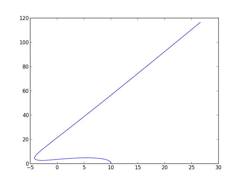

Hi! I am trying to simulate the rotation of a planet around a star, using the 2nd order Runge-Kutta method (I am starting with this and I will try 4th order later, I am new to this topic). I have this code but it doesn't work. When I plot y(x) I should get a circle, but I don't get it. Any idea what am I doing wrong? Thank you!
Code:

I spotted at least one major typo that would be throwing your simulation off:
ay2=G*b.mass*dx/(dist*dist*dist);
Change that to:
ay2=G*b.mass*dy/(dist*dist*dist);
You should look for additional typos.
