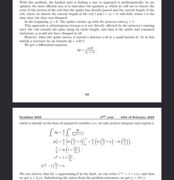

I have a problem whose description is below. I also add a solution of the problem.
I do not understand the ##p## number in the solution.
If the veil stretches prefectly, then when the princess moves by ##\Delta x##, then if the spider was not moving, he would also move by ##\Delta x## from the door, so he would be in the same distance from the princess. So assuming it, the time would be ##t_f=\frac {l_0}{u}## but that is no obviously correct.
Why? How is it then possible for the spider to catch her?
Take a look at the animation here. The symbol ##p## is the ratio of length of the stretching bar to the length that's behind the moving red dot. Initially ##p=0## and finally ##p=1## as the author of the solution claims. I suggest that you study this solution. It's the best I've seen on the web.

However, the spider is moving relative to the veil.
The solution defines ##p## as how far the spider is along the veil from its trapped end, as a fraction of the whole (instantaneous) length. At the start, this is 0. If the spider catches her, p will then be 1.
If that hurts the head too much, let the current length of the veil be ##L(t)=L_0+vt##.
Let the spider be at distance ##x=x(t)## from the princess. ##x(0)=L_0##. The part of the veil the spider is on is getting further from the princess at speed ##v\frac xL##. Relative to that, the spider is moving towards the princess at ##u##.
From these you can get a differential equation for x.
The relationship to the solution you posted is ##p=1-\frac xL##.
OK, I get it but the only thing that confuses me a bit is the fact that I cannot write the ##p## as ##\frac{ut}{l_0+vt}##.
I understand that at any time the spider moves by ##u\mathrm d t##, but I still do not know why I cannot write it like above.

You would need to write the position of the spider with respect to the door in the numerator. The denominator is the position of the princess w.r.t the door.
The idea is that ##u## is less than ##v##, that’s the seemingly paradoxical part. As long as ##u## is nonzero, the spider catches the princess…eventually. If ##p## was what you wrote, it would never have a chance of being 1.
That would be right if the spider were to have sat still while the veil stretched by ##vt##, then the princess stood still while the spider advanced ##ut##. But the spider moves while the veil is stretching, and traverses more of the veil's material in the early part than in the later.

Just for fun here is an alternative way to handle the math:
The velocity of the spider ##\dot x_s## with respect to the pinch point is given by:
$$ \dot x_s = u + \frac{x_s}{l + vt } v \tag{1}$$
Make the substitution that:
$$ \lambda = u + \frac{x_s}{l + vt } v $$
Now, differentiate ##\lambda## w.r.t. time ##t##:
$$ \dot \lambda = \frac{v \dot x_s}{l+vt} - \frac{v^2x_s}{(l+vt)^2} $$
Factor:
$$ \dot \lambda = \frac{v}{l+vt}\left( \dot x_s - \frac{vx_s}{(l+vt)} \right) $$
Notice that what is in parenthesis is identically ##u## by ##(1)##:
$$ \dot \lambda = \frac{v}{l+vt} u $$
Separate and integrate:
$$ \int_{\lambda_o}^{\lambda_f} d \lambda = u \int_0^t \frac{v}{l+vt} ~dt $$
$$ \implies \lambda_f - \lambda_o = u \ln \left( \frac{l+vt}{l}\right) $$
$$ \implies \left( \cancel{u} + \frac{x_s}{l + vt } v \right) - \cancel{u} = u \ln \left( \frac{l+vt}{l}\right) $$
Solving for ##x_s##:
$$ x_s = (l+vt) \frac{u}{v}\ln \left( \frac{l+vt}{l}\right) $$
To solve for the time ##t## when the spider reaches the princess note that ## x_s = l+ vt ##:
$$ \implies 1 = \frac{u}{v} \ln \left( \frac{l+vt}{l}\right) $$
finally solving for ##t## yields:
$$ t = \frac{l}{v}\left( e^\left( \frac{v}{u} \right) - 1 \right) $$
