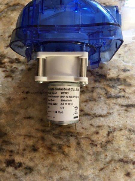

We cannot answer that question until we do not know what make and model peristaltic pump you are using.
Can you post a link to the technical data sheet.

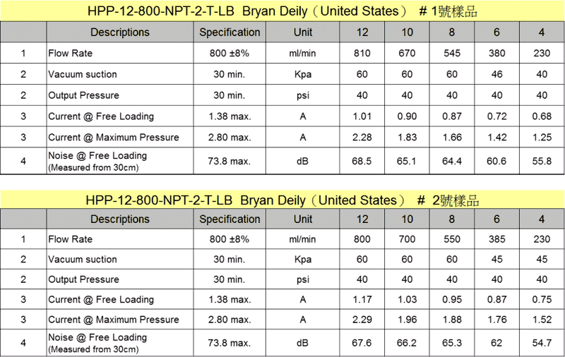

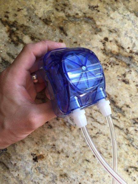

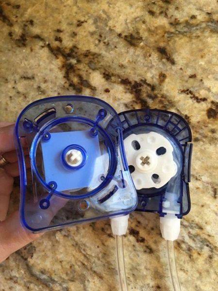

I got these two peristaltic pumps from China. Manufacturered by Honlite Industries. They manufacture pumps for a high end aquarium controller company Neptune Systems. These are their brushed motors rated at 800 ml/min. They run on 12v 3a. Here are the specs to each individual pump.
