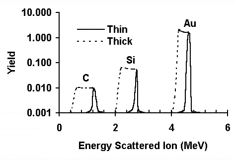

It is possible to have more than one peak per element but usually the beam energy is narrow enough to scatter from only one shell. Like this example (k-shell scattering):
Notice how the thickness shifts the energy peak - smearing it out.
This should also allow you to work out what you are looking for to locate the peak too.
IRL we would do interpolation to locate the top of the peak but anything near-by will probably be fine.
The width of the "thin" peaks (measured at half the height) is usually solely a characteristic of the detector. It is used to estimate the systematic uncertainty in the measurement.
Looks like your data has one double-peak ... maybe the same element responsible, you'll know when you do the math to find Z. The fat jagged peaks at low energy are often artifacts. Here's another example:
http://www.eaglabs.com/training/tutorials/rbs_theory_tutorial/silicide.php
notice - silicone is thicker than the tantalum, and the heavy tantalum is to the far-right close to the maximum energy. You'd expect the far right peak in your example to be Bismuth - giving you two Si peaks - perhaps your two different layers?
