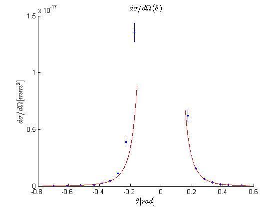

You were absolutely right. I have now corrected that and obtained 413 counts/second! However, when I am trying to fit my data to the theoretical formula, I obtain the plot in the attachment. Which raises two questions:
(1) I am not supposed to take the absolute value of all the angles, right?
(2) I cannot figure out why the plot won't reach the top most datum. I am limiting the range to -0.7 to -0.174, but that should still suffice. The model I am using for plotting the graph is of course the theoretical formula, namely:
[(zαzAue2)/(4Eeff)]2*(sin-4(θ/2)) = 1.6763*10-22*(sin-4(θ/2)) mm2, for zAu=79, zα=2, Eeff=4.4Mev
I am trying to compare between the two formulae and obtain a minimum chi squared to indicate the degree of congruity. Is it okay that the top datum is not intersected, or is there a better way to approach this?
NB The graph represents the readings registered using the Au leaf (i.e. the second part of the experiment)
Probably not.
The model is not perfect, I think. Extend the plotting range a bit and it could look better.
Could work, but does not have to.
Even when I extend the range it still doesn't intersect that top most value. Any idea why?
Unless I render it continuous, which is not what's desired.

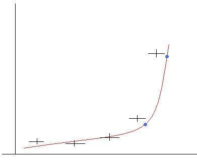

A fit function does not have to intersect everything, if it is close to that value it is probably fine. Is the angular difference between data and fit function within the uncertainty (or 2-3 times this value) for your angle?
I am not sure I understand what you mean. Would you please try to clarify?
An example "fit" (actually made with paint).
The black crosses are data points with uncertainties, the red line is the fit, the blue points mark the "actual" values corresponding to the rightmost two data points. They are close to the measured points, even if they are far above the fit function.
What is your precision for those angles in your data points?
