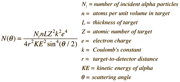

also, i don't understand how the scattering formula can become this one
from hyperphysics
its as though telling me that
NnLk2/4r2 = Z2
but if we add in the intensity like you suggested earlier, then it becomes
NnLk2/4r2 = Z2 N/L2 , assuming L2 is area
so only if this equation above is true, then we get the equation in the first post. but how is this equation as such bewilders me :(

The operational definition of [itex]d\sigma/d\Omega[/itex] is as follows: If you have N projectile particles (alphas in this case) coming into a "thin" target of thickness dx which contains [itex]n[/itex] targets (nuclei in this case) per m^3, and dN of the scattered projectiles emerge into a "small" solid angle [itex]d\Omega[/itex], then
[tex]dN = Nndxd\Omega\frac{d\sigma}{d\Omega}[/tex]
[itex]d\Omega[/itex] is determined by the cross-sectional area dA of your detector and its distance r from the target:
[tex]d\Omega = \frac{dA}{r^2}[/tex]
so
[tex]dN = Nndx\frac{dA}{r^2}\frac{d\sigma}{d\Omega}[/tex]
Verbally: the number of particles entering your detector is proportional to the the number of incoming particles, the number density of target particles, the thickness of the target, the cross-section area of your detector, and inversely proportional to the square of the distance between the target and the detector. [itex]d\sigma/d\Omega[/itex] is the proportionality constant. It can vary with the direction the the particles are scattered into (angle [itex]\theta[/itex] from the original beam axis, and angle [itex]\phi[/itex] azimuthally around the beam axis), and with the energy of the incoming particles.
This is for a "small" detector such that [itex]d\sigma/d\Omega[/itex] is effectively uniform over its area. For "large" detectors you have to take into account the variation with angle, by integrating over [itex]\theta[/itex] and [itex]\phi[/itex] subtended by the detector.
Also this is for targets that are "thin" along the incoming beam direction. For "thick" targets N decreases as the beam proceeds through the target, and you have to take that into account by integrating over x.
ah i see ! thanks!
