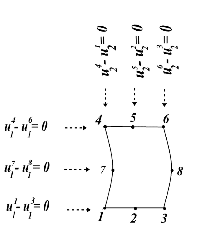

Yes its a 2D shell in a 2D space. I think I understand much of it now however I still have two questions.
I understand that when I put a constraint equation between two nodes on the opposite faces of an object in x-direction, I am telling those nodes that if the first one moves in x-direction(or y-direction) with a specific magnitude, the second one must also follow that node and move in the same x-direction with the exact magnitude and I have to do it with all node pairs on opposite faces so that it fits like a puzzle piece with adjacent RVE elements in an infinite medium who are also experiencing exact same deformations.
1) The paper that you referenced, talks about something called a dummy node. Its an arbitrary point with a prescribed value, either a displacement or a strain but why is it used, what happens when I use it and what difference does it make?
2) What should I do with nodes that are shared with more than one faces i.e corner nodes like Set 21, set 1, set 42, and set 22? Let's say when I am constraining the motion of bottom 2 corner nodes (set 21 and set 1), should I do it just in x direction or both x and y direction? I know for the rest of the nodes which aren't shared between more than one face are supposed to be constrained in both x and y direction.

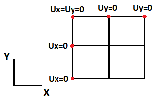

Dummy node approach is yet another method of introducing PBCs in Abaqus. This node is represented by a reference point feature. Instead of constraining motions of each node to its corresponding node on the other side you can constrain the motion of each node on one side to follow the motion of a reference point and to the same for another side (using second reference point). This way you will end up with only two points to control. It's a good option if you want to prescribe displacement to these periodic boundaries. In the article they use: $$u_{1}^{Left}-u_{1}^{Right}=0.01$$ When it comes to the second question, you can treat these periodic BCs as equivalent (or more advanced type) of symmetry. When you apply symmetry BCs to two orthogonal boundaries, the nodes shared between these boundaries also share the BCs. There's no conflict because each symmetry BC refers to different degree of freedom. Here's an example of a square with symmetry BCs applied to two orthogonal sides:
Thank you. I think I'm done with this part but just want to make sure if I did it correctly. I did something like this.
Is this correct?
Yes, it looks correct. For the future consider using Micromechanics plug-in. It should make the whole thing much easier. If you are not sure how to use it, there's a nice article about it on Simuleon's blog.
