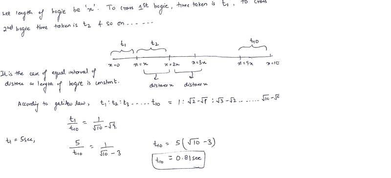

Galileo Ratio? But why squeroot? what am i missing?
s=u*t+a*t^2/2 VS 1:2:3:... t1/t10=s1/s10?
Hello! I can do this task just using this formula s=u*t+a*t^2/2.
But just saw an example where someone used this Galileo toerem.
Here is task:
"An observer stands on the platform at the front edge of the first bogie of a stationary train. The train starts moving with uniform acceleration and the first bogie takes 5 seconds to cross the observer. If all the bogies of the train are of equal length and the gap between them is negligible, the time taken by the tength bogie to cross observer is?"
Now please, if you look at picture, you see its t1/t10=1/(sqrt(10)-sqrt(9))My question is, why its in squeroot? Where do we get x^2? so to get squeroot we need x^2! but from what? Why the lenght, it its meter it should be as meter, so where we get m^2? What am i doing wrong. Thanks for any explenation!

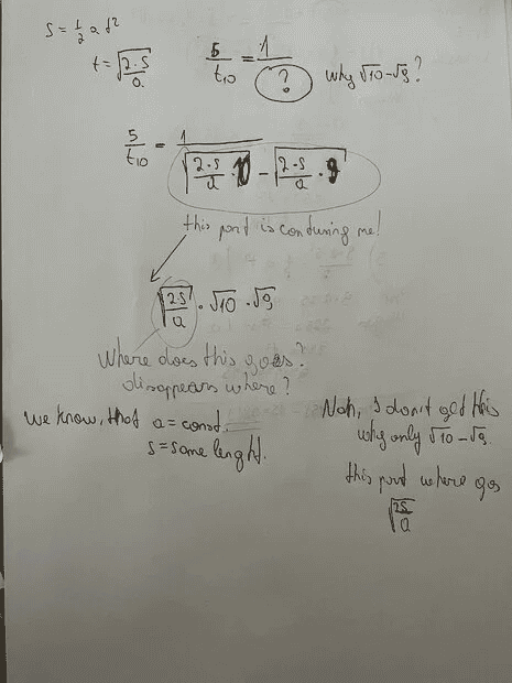

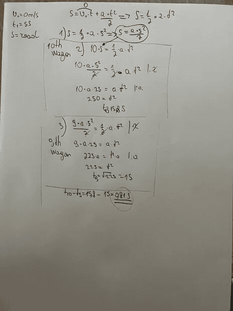

1st IMG _0370 picture, i got same result with just using physics method.
But in 2nd IMG_0371picture is what you sent me this morning! That mathematic ratio stuff.
And i am wondering about that part, where does that go!
Please, take a look at pictures, especially at 0371. what am i doing wrong by doing all that algebra stuff? Maybe wrong shortening?

We want to do this in the actual thread, not in private conversation: that way, others can correct any mistakes (which has already occurred at least once !)​
Also, we should type our equations using ##\LaTeX## for legibility​
Re IMG_0371:
The exercise asks for
So that is
the time from ##t=0## until the tenth wagon has passed the observer (let's call this ##t_{10}##)​
minus
the time from ##t=0## until the ninth wagon has passed the observer (let's call this ##t_{9}##)​
(Note that ##t_{10}## is defined differently here: with these definitions, the answer to the exercise is ##t_{10}-t_9## !)
And we were given
the time from ##t=0## until the first wagon has passed the observer (let's call this ##t_{1}##, 5 seconds)​
Let me correct my mistake(s) in #2
BvU said:
If a car has length ##l,## you know that ##\sqrt{l\over 2a}= 5## sec.
(using lower case ##l## was one, ##l\over 2a## instead of ##2l\over a## the other :rolleyes: and kuruman caught both !)
If one wagon has length ##L##, we can write$$
\begin{align*} t_1 &= \sqrt{\dfrac{2}{a} \,L} \\ t_{10} &= \sqrt{\dfrac{2}{a} \,10 L} \\ t_9 &= \sqrt{\dfrac{2}{a} \,9L} \end{align*}
$$so that our exercise answer becomes $$
\begin{align*} t_{10}-t_9 &=\sqrt{\dfrac{2}{a} \,10 L} \ - \sqrt{\dfrac{2}{a} \,9 L} \\
&=\sqrt{\dfrac{2}{a} \, L}\ \sqrt {10\;\vphantom{\dfrac{1}{1}}} \ - \sqrt{\dfrac{2}{a} \, L} \ \sqrt {9\;\vphantom{\dfrac{1}{1}}} \\
&= \sqrt{\dfrac{2}{a} \, L} \ \left (\sqrt {10\;} - \sqrt {9\;} \right ) \\
&=t_1 \left (\sqrt {10} - \sqrt 9 \right ) \end{align*} $$
Does this clarify things a little ?
