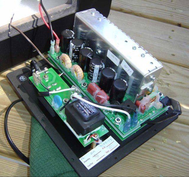

I am working on identifying an issue with blown fuses in a subwoofer for a friend. The subwoofer is a Velodyne SPL-R10. The subwoofer has blown several fuses and I am attempting to locate any loose connections that may have caused a short. I am very inexperienced with complex circuits such as amplifiers, so I assume that would be the main cause of a blown fuse, and would also be the only problem I would be able to fix.

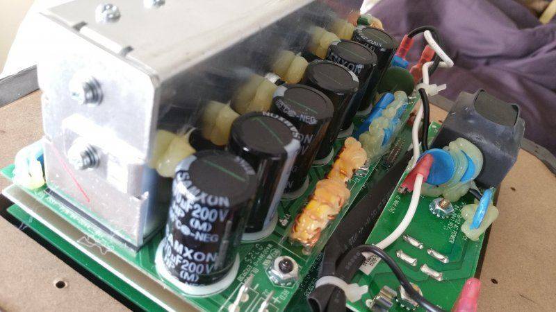

My question is, how do I discharge the capacitors on the circuit board? I opened the panel and see that there are 6 capacitors (all 200V 470uF) and I assumed that it would be dangerous to tinker any further. I know from my little knowledge of electronics that 200V is a substantial amount of voltage, and that the capacitors may still be charged.
Also, how do I tell how much current the capacitors would discharge? I know current (I) equals volts (V) * amps(A), but with a charged capacitor, I am not sure how to calculate it.

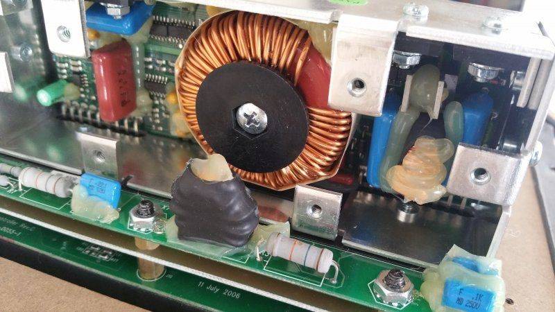

Attached is a picture of the capacitors, if it helps at all. I am not sure if the capacitors are in series, parallel, or even attached to one another in any type of configuration. There is also another picture of a copper coil of some sort. Is that an inductor? What is the purpose of this?
I appreciate any help with this, as I do not want to shock or especially electrocute myself. The grounding of the capacitors is my main concern, but I would also like to learn a few things in the process.

When the circuit is no longer 'live', I would think the charge stored in the capacitors would leak away to nothing in a relatively short time.
You could test that they are discharged by using a cheap domestic voltage meter across the terminals.
(set in the range for ~200v DC)
CORRECTION: not 10 ohms. 10k ohms.
You can use a high watt, low impedance, resister to short out the capacitor leads. 10k ohms will discharge it quickly. Don't be touching the bare resister wires. Don't underestimate how much juice they may have.

First - I have to take particular exception to Rootone's first post " I would think the charge stored in the capacitors would leak away to nothing in a relatively short time." -- Sorry I was a safety coordinator and the language I ALWAYS taught for electrical safety is ... "It is not what you THINK - it is what you KNOW" -- 200V can sit on a capacitor for a long time unless there is a specific discharge circuit built in, or by design. If you do not KNOW it is safe, then it is not safe!
As he later stated I agree - best to Measure with a voltmeter ( 600 V rated, DC ) -- the Safety Process is test the meter on a KNOWN source(something you KNOW has~ 200V), then the capacitor(s) you want to test (they should be well be low 50V before touching) and then back to the KNOWN source. If you do not have such a meter - you should not be dealing with this circuit. ALSO - the Voltage detectors sold in hardware stores are for AC voltages only and do not work on DC (as these caps would have)
A basic discharge jumper can be made with the resistor as noted above - cut an alligator lead in half and solder the resistor in the middle. then you have insulated clips with which to connect across the DC caps. When done put this where you will remember it - so it is always convenient.
