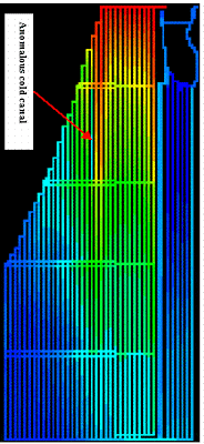

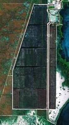

Speaking of Turkey Point, I was reading about that the other day, and how its ultimate heat sink is an elaborate canal system, miles and miles long (and I think I estimated about 10 square miles off of Google Maps)... And I thought to myself, "why in a hot, humid climate like the southern tip of Florida, would the heat sink be canal systems".. I imagine they need to be that long due to how hot it is, that heat removal is so inefficient. It seems so obvious to me, and I feel like cooling towers would have been much more appropriate and MUCH less environmentally invasive. What was the reasoning behind the canals?! It was bothering me.
On another note, getting back to natural circulation. I found the equations to use in the above post and solved the problems without issue, and posted the equations in the homework thread (for anyone else that may stumble upon this thread some day). As for another inquiry:
Does natural circulation ALWAYS happen in a power plant, or does it only happen when the plant loses all power? And I guess from an operator's standpoint, when the plant loses all power (normal and emergency), what kinds of things are monitored (alarms, gauges, etc.) to make sure that its working and the plant is becoming stable again?
  • #55
Nobody had built a salt water cooling tower at the time, around 1969.
There was concern about salt spray drifting downwind and ruining the potato fields. A surprising fraction of the country's winter potatoes comes from those fields . Hurricane Donna in 1960 had put so much salt onto them it was a decade before the ones within a few miles of the bay recovered.
Also the dewpoint in S Florida runs so high there was concern over just how well they'd work in summer months, when air conditioning load strains the electric grid down there. . When temperature and humidity are both 100 your sweat just doesn't evaporate.
Actually they built a small test tower and concluded they were glad they'd opted for the canals. They cool a lot by emitting radiant heat.
images courtesy of http://lew-cabintalk.blogspot.com/2012_02_01_archive.html
Crocodiles moved right into the canals and are doing very well. An eighteen footer used to hang out on our intake. Most days you can hear them grunting adjacent the employee parking lot.
I figure they're another level of security.
FOR A SPECIES that, as recently as last year, was listed as endangered, the American crocodile is surprisingly easy to find--as long as you can get past the armed guards. More than one-fifth of the crocodile's U.S. population, about 400 juveniles and adults, lives at Florida Power and Light's (FPL) Turkey Point nuclear power facility in Homestead, Florida.
http://www.nwf.org/news-and-magazin...hives/2008/why-is-this-crocodile-smiling.aspx
