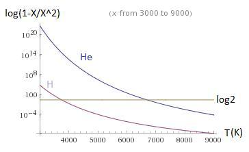

Hi,
The Saha equation for a procedure [itex] a^+ + e \leftrightarrow a + \gamma [/itex] is:
[itex] \frac{1-X}{X^2} = \eta \frac{g_a}{g_{a+}g_e} \frac{4\sqrt{2} \zeta (3)}{\sqrt{\pi}} \Big( \frac{T}{m_e} \Big)^{3/2} \exp \Big[ \frac{E_{binding}(a)}{T} \Big] [/itex]
where [itex]X = \frac{n_{a+}}{n_B}[/itex] and [itex]\eta = \frac{n_B}{n_\gamma} [/itex]
I worked with this equation for [itex]\eta = 5.5 \times 10^{-10}[/itex] and for [itex]a=H[/itex] and [itex]a=^4He[/itex]. The results I got for [itex]\frac{1-X}{X^2}[/itex] are given the figure picture.
The above Helium line was taken by the assumption that baryonic matter consists only out of Helium at recombination time...
From the log(2) we can see the recombination temperature for both these cases.
I have one question though. Today the temperature is [itex]T \approx 2.725~K[/itex]. So the above line today is going to give me the fractional ionization [itex] X [/itex] for today, right? Is it possible to calculate this fraction though experimentally?
If not, what are the experimental informations you can take from such a diagram?
Also without knowing the value today, how can people determine either the recombination temperature or the fraction of [itex]\eta = n_B/n_\gamma[/itex]?

ChrisVer said:
So the above line today is going to give me the fractional ionization X X for today, right?
Only if the universe is in thermal equilibrium. Do you expect this?
The ionization fraction in the early universe.

So suppose that there are two hypothesis and you want to check them:
1. the baryon number during recombination consisted mainly of He
2. The baryon number during recombination consisted mainly of H
By the plot above, and measurements you can do today, can you verify either the Hyp#1 or Hyp#2?
The ratio H/He today is nearly the same as during recombination, so it is easy to get that ratio.
To see which type was type did recombination later (=what produced the CMB), you can look at the plot in post 1.

So in fact, if baryonic number consisted mainly of Helium, the universe would have been transparent to the photons at higher temperatures (=earlier) and thus the radiation temperature from CMB would have been larger today? :)

The temperature at the (last) recombination would have been higher, but it would have happened earlier, so the universe would still have had time to cool down afterwards. I guess it would depend on the details like the actual helium density (do you convert all hydrogen to helium, or do you just remove hydrogen?).

The one plot [for Hydrogen] was taken by considering what they state in the link I sent: there was no Helium (Helium neglected)...
The second plot [for Helium] was taken by considering again that there was only Helium (nothing else consisted the baryonic number).
So I guess I what I did was to remove the Hydrogen in the calculations.
I may also be wrong by trying to figure anything out of that graph...
But if the universe became transparent at the recombination time, and that is the time we see in CMB, if it had became earlier we would see its "earlier" stage and not the later one (which occurred at Hydrogen). And so it would appear hotter.
