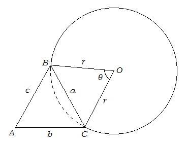

How to solve this maths problem?
So we have a triangle ABC with given sides. On the BC side, there's a part of a circle (we do not know how much of a circle). We are asked to find the angle A to ensure that the part of a circle has the same area as the triangle. The problem boils down to finding how to calculate the area of the part of circle. So how would you go about doing it?
Thanks

Hello Salim,
Please refer to the following diagram:
We may determine $\theta$ using the Law of Cosines:
\(\displaystyle a^2=2r^2\left(1-\cos(\theta) \right)\)
\(\displaystyle \theta=\cos^{-1}\left(\frac{2r^2-a^2}{2r^2} \right)\)
From this, we may determine the area $A_S$ of circular sector $OBC$:
\(\displaystyle A_S=\frac{1}{2}r^2\theta=\frac{1}{2}r^2\cos^{-1}\left(\frac{2r^2-a^2}{2r^2} \right)\)
And we may now also determine the area $A_T$ of triangle $OBC$:
\(\displaystyle A_T=\frac{1}{2}r^2\sin(\theta)=\frac{1}{2}r^2\frac{a\sqrt{4r^2-a^2}}{2r^2}=\frac{a\sqrt{4r^2-a^2}}{4}\)
Thus the portion of the circle's area $A_O$ outside the triangle is:
\(\displaystyle A_O=\pi r^2-\frac{1}{2}r^2\cos^{-1}\left(\frac{2r^2-a^2}{2r^2} \right)+\frac{a\sqrt{4r^2-a^2}}{4}\)
Equating this to the area of triangle $ABC$, we obtain:
\(\displaystyle \frac{1}{2}bc\sin(A)=\pi r^2-\frac{1}{2}r^2\cos^{-1}\left(\frac{2r^2-a^2}{2r^2} \right)+\frac{a\sqrt{4r^2-a^2}}{4}\)
Hence, solving for $A$, we obtain:
\(\displaystyle A=\sin^{-1}\left(\frac{2r^2\left(2\pi-\cos^{-1}\left(\dfrac{2r^2-a^2}{2r^2} \right) \right)+a\sqrt{4r^2-a^2}}{2bc} \right)\)
