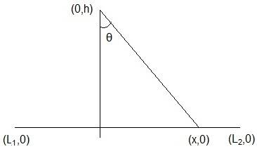

Hello Samantha,
I would solve this problem in more general terms, derive a formula, then plug the given data in.
Suppose we let the camera be $h$ units above the hallway, and the hallway extends $L_1$ units to the left of the camera and $L_2$ units to the right. Let the angle $\theta$ of the camera's angle of rotation be zero radians directly below the camera.
Please refer to the following diagram:
Hence the angle of rotation will be confined to the interval:
$\displaystyle -\tan^{-1}\left(\frac{L_1}{h} \right)\le\theta\le\tan^{-1}\left(\frac{L_2}{h} \right)$
We can see that for any positive value of $h$ and any finite values of $L_1$ and $L_2$, we must have:
$\displaystyle -\frac{\pi}{2}<\theta<\frac{\pi}{2}$
Now, letting the position of the camera's beam on the floor of the hallway be $(x,0)$, we have the following relationship between this position and the angle of rotation:
$\displaystyle \tan(\theta)=\frac{x}{h}$
Differentiating with respect to time $t$, we find:
$\displaystyle \sec^2(\theta)\frac{d\theta}{dt}=\frac{1}{h}\frac{dx}{dt}$
We require $\displaystyle \left|\frac{dx}{dt} \right|=k$ where $0<k\in\mathbb{R}$. Hence:
$\displaystyle \frac{d\theta}{dt}=\frac{k}{h}\cos^2(\theta)=\frac{k}{h}\frac{h^2}{x^2+h^2}=\frac{kh}{x^2+h^2}$
Using the given data, we find the angle of rotation will vary from:
$\displaystyle -\frac{\pi}{4}\le\theta\le\frac{\pi}{4}$
where:
$\displaystyle \left|\frac{d\theta}{dt} \right|=\frac{50k}{x^2+50^2}$
and:
$\displaystyle -50\le x\le50$

Mark,How did you arrive at
$\displaystyle \frac{k}{h}\frac{h^2}{x^2+h^2}$
From $\displaystyle \frac{k}{h}\cos^2(\theta)$

If we have defined:
$$\tan(\theta)=\frac{x}{h}$$
This means in the right triangle the side opposite from $\theta$ is x and the side adjacent is $x$. By Pythagoras, the hypotenuse must then be $$\sqrt{x^2+h^2}.$$
As cosine is defined to be the ratio of adjacent to hypotenuse, we then find:
$$\cos(\theta)=\frac{\text{adjacent}}{\text{hypotenuse}}=\frac{h}{\sqrt{x^2+h^2}}$$
Hence:
$$\cos^2(\theta)=\frac{h^2}{x^2+h^2}$$
Does this make sense?

Perfect sense! Thank you!
