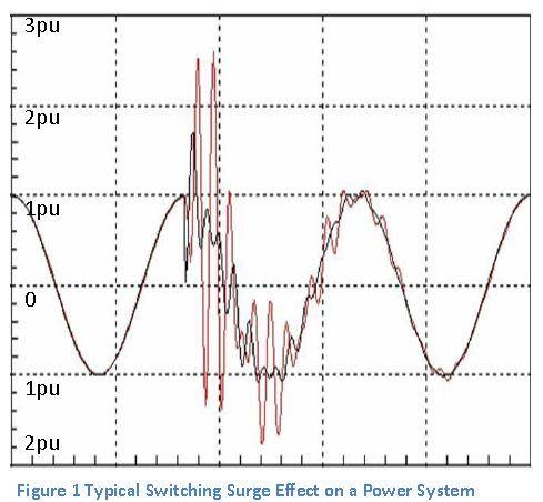

I recall struggling with this problem years ago when designing algorithms for digital devices to protect power systems. Obviously, a protection device should decide what it sees, and trigger corrective actions as rapidly as possible. On the other hand, it should have zero false positives where it jumps to the wrong conclusion.
If everything is ideal and perfect, you can do it with 4 samples as @Hesch said, (actually 3 samples if you assume the DC offset is zero). But real life waveforms are far from ideal, especially in transient states.
Bottom line, there is a trade-off between sampling rate, number of samples, and the quality of your calculated result. So unless you specify your accuracy/reliability requirements, and the details of what you are measuring and your apparatus, your question can't be answered.

What I had in mind is that power system waveforms can be very noisy, especially with switching surges.
The most reliable way to measure fundamental frequency via sampling is to measure the delay between zero crossings. You can make a band-pass filter by ignoring crossings except those which occur within a defined time window of the previous crossing.
