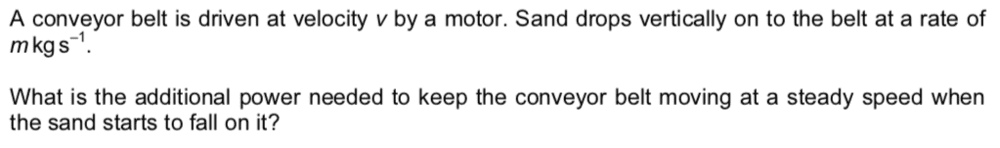

A conveyor belt is driven at velocity ##v## by a motor. Sand drops vertically on to the belt at a rate of ##m~kg~s^{-1}##.
What is the additional power needed to keep the conveyor belt moving at a steady speed when the sand starts to fall on it?
##E_K=\frac{1}{2} m v^2##, ##p=mv##, ##F=\frac{\Delta p}{\Delta t}##

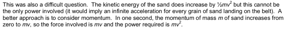

I can understand how it can be explained using the change of momentum to find the average force on the belt, then us $$P=Fv$$ to get the power.
What I didn't understand is why the energy solution won't work. If in 1 second, sand with mass m has fallen on the belt and accelerated to speed v, then the sand has gained kinetic energy $$E_K=\frac{1}{2} m v^2$$. As the mark scheme does confirm this is the amount of energy gained by sand, it states that this cannot be the only energy involved here, otherwise the acceleration of a grain of sand will be infinitely large.
I couldn't understand what does it have to do with the acceleration of sand, after all, if we assume the belt is way more massive and sticky, then the acceleration of sand in this case would indeed be very very large.

When the sand grains are falling on the conveyor belt, there is inelastic collision as a consequence of which, the sand sticks to the surface of the conveyor belt and starts moving alongwith the belt. If, instead of inelastic collision, elastic collision would have happened, then the sand particles would have bounced back in the direction opposite to their initial direction.
Now, since there is inelastic collision, therefore some amount of energy has gone out of the system of sand and the belt. Therefore, energy equations will not give you right answer in this particular case.

That's a weird explanation.
Obviously no individual grain of sand can get to speed v instantly, but that has nothing to with elastic versus inelastic collision. Most likely, each grain tumbles backwards relative to the belt at first, taking a little while to match the belt's speed.
If the collision between sand grains and belt has nothing to do with elastic/inelastic collision, then by what mechanism are the sand particles sticking to the belt and start moving alongwith the belt ?

I wrote that the impossibility of getting instantly to the speed of the belt has nothing to do with elasticity. This is in response to the quoted "infinitely large acceleration" argument. Whether they bounce or stick, the velocity change takes a little time.
Certainly elasticity would make it impossible to match the velocity of the belt at all. They would bounce in any number of directions.

If you use the energy equation and calculate the extra kinetic energy acquired by the added mass, you are only calculating the energy given to the mass m to accelerate the mass m from zero speed to v. But this in not the only thing which happens so that calculation is completely irrelevant. **
When the mass drops on the belt, it slows the belt to a speed less than v. This is your starting position.
First, you use conservation of momentum to calculate the belt speed immediately after the load lands.
The motor now requires additional power to accelerate the "belt with its existing previous load plus the mass dropped onto it, all moving at less than v", back to v.
Note how, at the beginning, the belt has no load, so the belt will be slowed a lot. The power is required to accelerate a small total mass by a large velocity.
Later on, the belt will have a large existing load, so it won't be slowed much. The power is now required to accelerate a much larger total mass by a much smaller velocity.
As all the equations are linear these two required powers: "small total mass by a large velocity" and "large total mass by a small velocity", are equal so the additional power will be constant over time.
** I suppose you could calculate this, and then calculate the energy required to accelerate the "belt and existing load" from the "slowed to below v" velocity back to v. Add this to the KE acquired by the dropped mass being accelerated to v and you will get the same answer.

I think you are misunderstanding what the OP is saying.
He calculates the energy required to be ##mv^2## which is correct. Note it is twice the extra energy acquired by the mass alone, which is ##\frac{1}{2}mv^2##.
So, one half of the power goes to accelerate the mass and one half the power goes to accelerate the belt and load back up to speed.
The question he asks is: why does the last term in ##mv^2 - O(\frac{m}{M})## exist? Why isn't the answer just ##mv^2## without the ##O(\frac{m}{M})## last term? He is not asking why his answer ##mv^2## is different from ##\frac{1}{2}mv^2## for the mass alone.
The reason is because he has used an infinite expansion approximation to do the calculation which assumes ##m/M## is very small, and he discards later terms. Had he not used the approximation and instead worked through the reorganisation of the expression, he would not have got that term (which, in any case, tends to zero).
