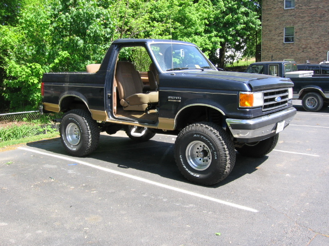

I have a scene in a story where a full-size lifted bronco with 35” tires is sliding skewed down a steep sandy hill. The driver cranks the wheel upon seeing a ledge which fails to change the trajectory of the vehicle, now sliding on sandy gravel at about 20 MPH. The rim of the front wheel connects with a boulder that doesn’t budge, stopping the wheel immediately, however the rear of the vehicle pitches and the incline + momentum takes the bronco over a cliff.
The drop is a sheer 10m (30ft) to a pond of standing water only disturbed by the gravel falling in ahead of the vehicle. The pond is 10ft deep at point of impact. The bronco has a hard top and windshield over the front cab, nothing over the rear seats, and no doors. See the example photo: https://www.broncozone.com/uploads/post-4365-1146769033.jpg
This happens at night and with the lights off its pitch black. A driver and passenger knew of the cliff and water only because the headlights reflected off it. Realizing the bronco will land upside down, the two mutually conclude to unbuckle and jump away from the bronco, getting out of the vehicle when it is perpendicular and barely in free-fall from the cliff.
My questions as follows:
  • Would the momentum of the vehicle pitching forward have a realistically debilitating impact on the driver and passenger being physically able to jump free from the vehicle?
  • Would they be able to get far enough to the side as not to get caught beneath it?
The two know there’s water and roughly how far away it is but can’t see it that well or at all in the dark. It’s a 30’ drop, plus whatever momentum they had already from pitching off the cliff. They’re both high school girls of average fitness, though one is tall and thick boned. Presumably they would hit the water face forward, mostly head down and with arms flailing. They would impact slightly after the vehicle broke the surface.
  • What kind of injuries would they more than likely sustain from water tension, and would it be believable the two are in good enough condition to swim after impact?
  • Would 10ft of water be deep enough to stop them from hitting the bottom?
  • With the front of the vehicle having come to a dead stop against a boulder and momentum pitching the rear of the vehicle over the edge, what part of the vehicle would likely break the surface of the water first, and what impacts would this have on the two passengers falling into the water beside it in regard to surface tension and either pushing them away from or pulling toward the vehicle?
  • As it is an open cab, would air have any chance to slow the vehicle or would it plunge like a rock right through to the bottom?
  • How long would the headlights remain lit before shorting out, plunging them in darkness?
  • Would the engine hydro-freeze before the headlights shorted out? Would this happen simultaneously?
Based on the answers I may have some follow-up questions. The scene doesn’t need to be muddled down with all this plausible science but does need to be more authentic than your everyday Hollywood movie.
Thanks in advance for anyone willing to discuss on making the scene as plausible as possible! :smile:
