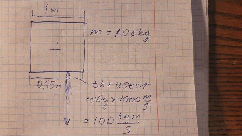

I'm trying to better understand classical mechanics, and came up with a question:
Say we have a squared satellite weighting 100kg, 1 meter on each side. it has a thruster on it's side, shown in picture
thruster quickly ejects 100g of propellant with a speed of 1000m/s giving a satellite 100kg m/s of momentum. the question is how much of it will be given to rotation, and how much - to linear motion

You have a cube to which an impulse Δp = 100 kg⋅m/s is delivered at the indicated point, 0.75 m from the edge. You say that the cube will translate and rotate at the same time. I agree.
Question 1. After the impulse is delivered, what quantities related to the motion of the cube are conserved and why?
Question 2: What are the mathematical expressions for the quantities that are conserved?
Question 3: Given the expressions in the previous questions, what additional quantities related to the cube need to be specified?
That is the beginning. Once you answer these questions, we will have something to refer to as we proceed to answering your question. As I was typing this, I noted that @haruspex also has some questions that you should consider answering.

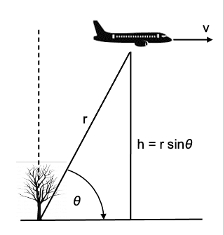

Here is a picture that might help you understand angular momentum. As @haruspex already mentioned in post #10, the definition of angular momentum is
##\mathbf{L}=\mathbf{r}\times\mathbf{p}=m\mathbf{r}\times\mathbf{v}.## The magnitude (size) of angular momentum can be written as ##L=mvr\sin\theta## where ##\theta## is the angle between the position vector to the moving object and its velocity vector. Now look at the drawing below.
The plane is flying in a straight line above ground at fixed height ##h##. The position of the plane relative to the base of the tree is ##r##. According to the definition, the plane has orbital angular momentum ##L=mvr\sin\theta=mvh## about the base of the tree even though it is flying in a straight line. "Well", you might ask, "how can it have orbital angular momentum if it is not rotating about anything?" The answer is "But it is rotating!" Rotation involves an angle changing with time. Here angle ##\theta## is changing with respect to time and that is sufficient to establish rotation. The plane doesn't need to follow a circular path in order to be considered as orbiting the base of the tree.
Likes vasya, jbriggs444 and haruspex

Well, let us see. 100 kilogram satellite given 100 kg m/s of momentum. You get linear velocity of 1 m/s.
Yes. That is the correct answer.
vasya said:
angular velocity 1.5 rad/s
Well, let us see. The moment of inertia of a 100 kg cube that is 1 meter on a side about its center. ##\frac{1}{12}m(h^2+w^2)##. Yes, that comes to 16.67 kg m2, just as you have it.
The angular momentum of 100 kg m/s of linear momentum at a perpendicular offset of 0.5 meters is 50 kg m2/s. Divide by 16.67 kg m2. I make that 3 inverse seconds (which means 3 rad/sec).
One of us is off by a factor of two.

conflict is that we have 10000 N burst lasting 0.01s on input, 100 kg*m/s of linear momentum and additional 1.5rad/sec of angular velocity on output. 1.5rad/sec*16.66= 25 units of angular momentum. 100 on input, 125 on output
You are adding linear momentum to angular momentum and expecting the total to be conserved?!
Linear and angular momentum are conserved separately. Not as a sum. They do not share the same units! Adding them together would yield a meaningless result since it would have no particular units.
Linear momentum: 100 kg m/s in. 100 kg m/s out. Conserved.
Angular momentum: 50 kg m2/s in. 3 rad/sec * 16.67 kg m2 out = 50 units of angular momentum out. Conserved.

By my calculations, initial angular momentum is zero and final angular momentum is zero as well. Angular momentum is conserved after all.
The initial angular momentum consists of two parts.
1. Unburnt rocket fuel sitting motionless in a rocket pod.
2. A motionless craft.
The final angular momentum consists of two [or three after an edit] parts.
1. An expanding plume of rocket exhaust of unknown mass and velocity that has 100 kg m/s of linear momentum at an offset of 0.5 meters from the craft's center of mass for a total of -50 kg m2/s.
2. A rotating craft with a rotation rate of 3 rad/s and a moment of inertia of 16.67 kg m^2/s for a total of +50 kg m2/s.
[3. A moving craft with an offset of 0 meters from the reference axis and, thus, zero angular momentum from its linear motion]
I adopt a reference axis at the center of the craft. Other possibilities exist and result in different numbers for angular momentum. However angular momentum is conserved regardless of the choice of axis, as long as that axis is inertial.

Yes, that's probably the blunder. I was thrown by
vasya said:
angular momentum in linear … motion
taking that mean the linear momentum's contribution to angular momentum.
  • #35
look more closely on first picture in this thread. thruster has offset of 0.25m of y-piersing-through-the-center-of-mass axis
Likes jbriggs444
