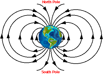

To induce a current, the magnetic field through a loop must be changing (in magnitude or direction or both). For the ISS in a mostly equatorial orbit, the magnetic field is pretty much the same magnitude, and pointing the same direction for its whole orbit.
For a satellite in a polar orbit, the magnitude and direction will change, but very slowly (it takes half an orbit to reverse the direction), and the Earth's magnetic field is very small, especially at orbital heights. With a sensitive instrument, you could detect the changes, but it should not pose a problem for most circuitry in a satellite or space station.
http://www.unc.edu/depts/oceanweb/turtles/geomag.gif

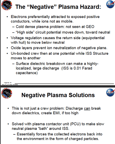

Hello Aden, :welcome:
It's one of the ISS issues, yes.
Here is a picture on page 25
Likes davenn
Interesting, I didn't now the ISS orbit was inclined that much. Still, I guess I'll have to do more reading to see how such a small change in B-field can induce much in the way of voltages or currents...
BvU said:
Hello Aden,
but fortunately one that was solved and alleviating the threat :smile:
