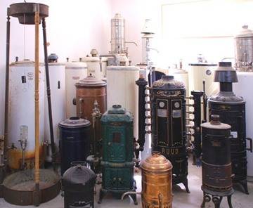

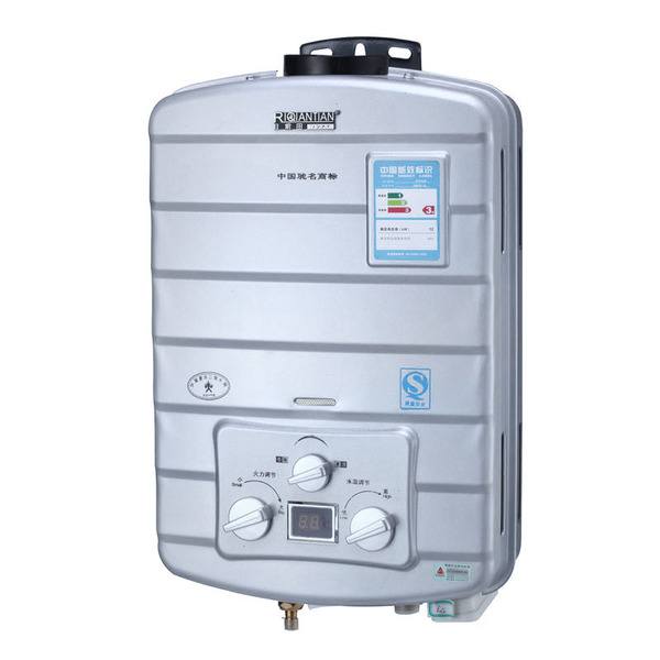

ps. Pardon our confusion, but American geysers look like the following:
and not like the following:
But it's interesting that our geyser and your geyser's purpose seem to be somewhat related:

Great visuals but I still have no idea what a non-American geyser is. Presumably something to do with household water?
It's a small wall-mounted water heater for a single room, usually the bathroom.
I first saw one when I visited a cousin in Germany almost forty years ago.
The visuals were hyperlinked, just in case someone got confused, as I was at first.

A geyser, pronounced "geezer", is a water-heater, not necesarily a small one for one room.
