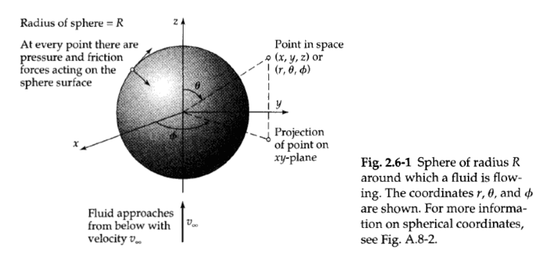

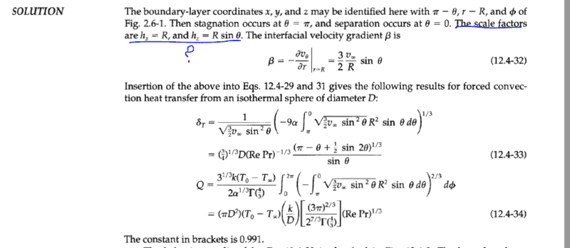

- Homework Statement
- how they get that result
- Relevant Equations
- Geometric relations
how they got that value for the scale factors h?
Scale factors in spherical coordinates are used to convert between different coordinate systems and represent the changes in distances and angles. They are also known as metric coefficients or Jacobian determinants.
The scale factors in spherical coordinates are calculated using the partial derivatives of the spherical coordinates with respect to the Cartesian coordinates. The scale factors for radius, polar angle, and azimuthal angle are given by 1, r, and r sin(theta), respectively.
