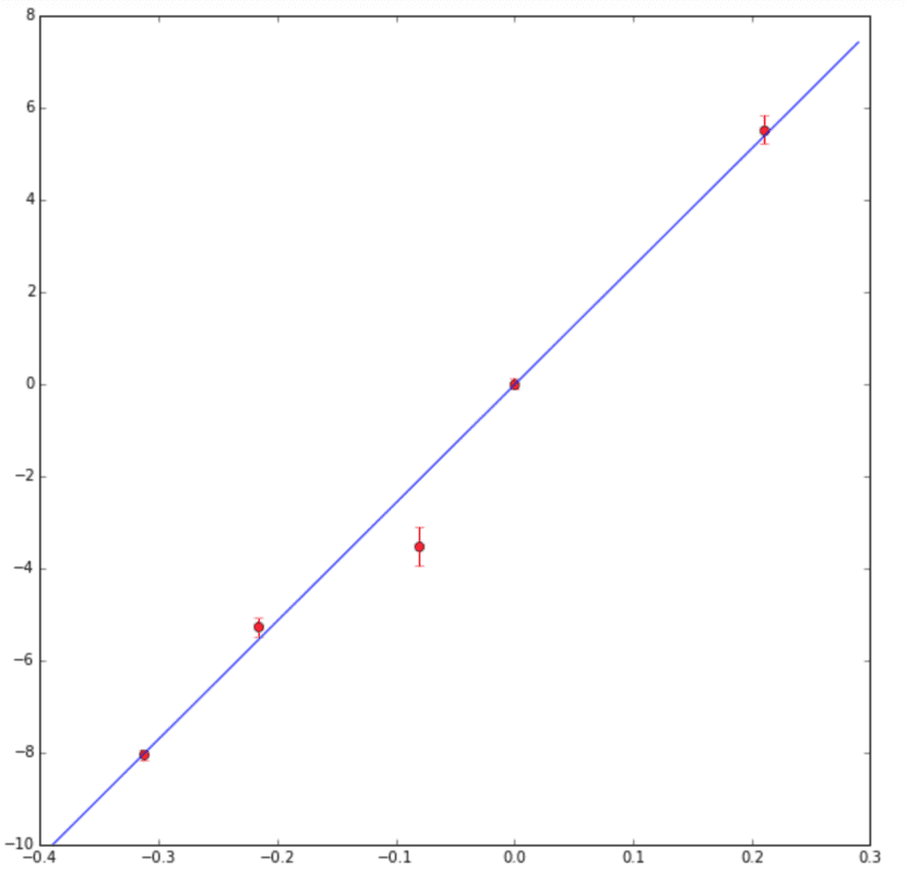

Thank you again for your reply! Here is my actual data that I am trying to fit:
##x = [-0.312, -0.217, -0.081, 0., 0.211]##
##y = [-8.050, -5.278 , -3.510, 0., 5.521]##
##y_{err} = [0.121, 0.218, 0.421, 0.115, 0.305]##
I also attached the plot with the fit I get. (I am using the lmfit package in python). When I use scaled covariance I am getting these parameters for the fit:
line1intercept: -0.02108874 +/- 0.20201635
line1slope: 25.6603677 +/- 0.95263756
when I don't use scaled covariance I am getting this:
line1intercept: -0.02108874 +/- 0.09520060
line1slope: 25.6603677 +/- 0.44893231
The reduced chi squared is 4.50291419. Is there something I am doing wrong? To me the fit looks pretty good (and there are some theoretical motivations for a straight fit, too). Thank you, again, for the help.

The central data point is a bit over 3 standard deviations away from the fit. If you think this is a good data point and nothing went wrong with it use the scaled up uncertainties. Most likely something went wrong there, so it is better to be conservative.

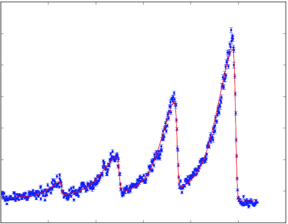

Thank you for this! I digged a bit deeper into my problem, more specifically where are my errors coming from. I have a counting measurement and I fit my points with a curve. From there I extract the centers of the peaks for different measurements and the plot I showed previously shows the difference between such centers. So the errors there come from the error on the centers of the peaks i.e. from the errors given by the fitting program (which is the same as before, lmfit). I attach below such a counting fit. I have noticed that here I have exactly the same problem as before: scaling my errors give me twice the errors on the parameters (mainly the peak center) compared to when I don't scale them. So the issue I mentioned above, I think, it's just a propagation of the issue from here. In the plot below, the errors are just Poisson i.e. square root of the number of counts. Also the fit is motivated on theoretical grounds. Do you know why do I have this problem here, in the first place when in principle, both the fit and the errors should be right? Thank you so much for your help!

Your uncertainties are clearly smaller than the spread of the measurements. Something makes them spread by more than the square root of the counts. In addition the fit doesn't do a good job in the two larger peaks and it overestimates the flat area to the right of the last peak.
