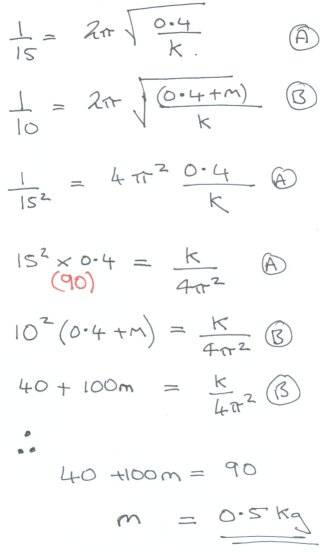

A mass spring system carries a mass of 0.4kg. When the point of suspension is made to vibrate verticaly at a frequency of 15Hz resonance occurs. What mass should be added to the 0.4kg in order to reduce the resonant frequency to 10Hz.

T=2∏√(m/k)
15=2∏√(0.4/k)
15=2∏√(0.4/k)
10=2∏√(0.4+x/k)
Do I rearrange these so I have all the constants on the rhs then equate the lhs and solve for x if that makes sense?
Any help appreciated
It wouldn't really make sense to try to 'put all the constants on the RHS of the equation' - everything in the first equation is a constant and we know that 'x', the only variable in the second equation, cannot be zero.
Consider, instead, that 'k', as a property of the spring, will not change between the two scenarios.

I just realized the T=1/f mistake
Thanks for the help
0.06=2∏√(0.4/k)
0.1=2∏√(0.4+x/k)
So I still can't seem to get 0.5 out of the rearrangement and equation of the two formula.
I'm able to get x=0.5kg by that method, actually. If you leave '1/15' on the LHS of the first equation rather than approximating it as '0.06', you should find the same.
