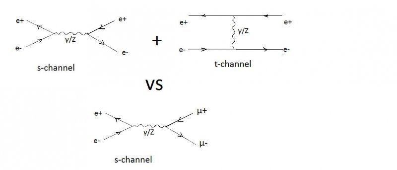

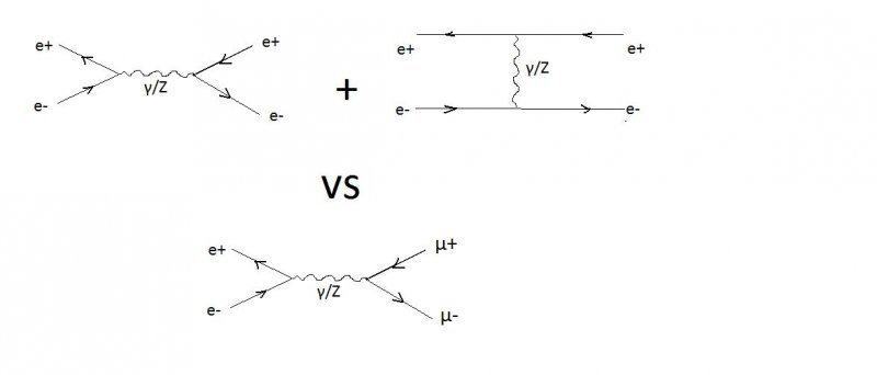

The part a is clear for you I think... Even for photon interactions alone, the ratio you give approaches 1 for high energies...it can also be done for the Z0.
For part b, you don't have to think of propagators alone...
you can have:
[itex]e^- e^+ \rightarrow \gamma^* \rightarrow e^- e^+[/itex] (s-channel)
as well as
[itex] e^- e^+ \rightarrow e^- e^+[/itex] ...by t-channel...they don't have to annihilate to photon and produce the pairs again as you have to do for the case of muon products.

For high energies, the propagators of the weak and electromagnetic interaction are the same. It goes as [itex]\frac{1}{s}[/itex]
The difference comes by the 2nd diagram that is possible for the electron/positron products interaction and doesn't exist for the muons.

Which process dominates? Which is the "s-channel" and which is the "t-channel"?
In my figure the diagram with muons and the same one with electrons are the s-channel processes.
The extra diagram for the [itex]e^- \rightarrow e^-[/itex] and [itex] e^+ \rightarrow e^+[/itex] which exists only for the [itex]e^-e^+ \rightarrow e^+ e^-[/itex] process is the t-channel...
I don't understand what you mean by "dominates". I am explainging why:
[itex] \frac{e^+e^- \rightarrow \mu^+\mu^-}{e^+e^- \rightarrow e^+e^-}[/itex] shouldn't be 1.

All three are in the same picture.
By "dominate" I mean which is most frequent/most likely?
