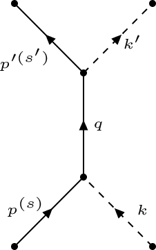

I am working on the following problem: I would like to determine the invariant Matrix element of the process ##\psi\left(p,s\right)+\phi\left(k\right)\rightarrow\psi\left(p',s'\right)+\phi\left(k'\right)## within Yukawa theory, where ##\psi\left(p,s\right)## denotes a fermion with momentum p and spin s and ##\phi\left(k\right)## denotes a real scalar particle with momentum k. The Lagrangian is given by:
##\mathcal{L}=\overline{\psi}\left(i\gamma^\mu\partial_\mu-M\right)\psi+\frac{1}{2}\left(\partial_\mu\phi\right)\left(\partial^\mu\phi\right)-\frac{m}{2}\phi^2-g\overline{\psi}\psi\phi##
Which Feynman diagrams contribute on tree level and how are they translated into the invariant matrix element? Following my considerations, this is the s-channel only, which is represented by this diagram:
I would write the matrix element as follows:
##i\mathcal{T}=\int\frac{dq^4}{\left(2\pi\right)^4}\overline{u}_{s'}\left(p'\right)\left(-ig\right)\left(2\pi\right)^4\delta^{(4)}\left(q-p'-k'\right)\frac{i\left(\gamma^\mu q_\mu+M\right)}{q^2-M^2}\left(-ig\left(2\pi\right)^4\delta^{\left(4\right)}\left(p+k-q\right)\right)u_s\left(p\right)##
which yields this invariant matrix element:
##\mathcal{M}=-\frac{g^2}{s+M^2}\overline{u}_{s'}\left(p'\right)\left(\gamma^\mu q_\mu+M\right)u_s\left(p\right).##

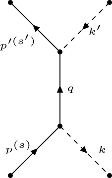

Are my considerations correct? According to the exercise I should get two diagrams. However, I could only imagine one further situation with the scalar particle's momentum inverted, meaning this diagram:

You can couple the outgoing scalar particle to the fermion "before" your incoming scalar particle.
That's the only way I see to make a different diagram.
Likes vanhees71
Note that, for the purpose of drawing those two diagrams, it may be clearer to interchange the outgoing fermion and scalar. It should then be clear that one of the diagrams is the s-channel diagram and the other a t-channel diagram.
