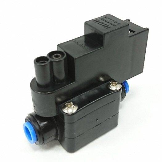

Does anyone have internal schematics (or illustration) how this thing work inside? Like how water flow can activate the conduction to the two wires connected?
https://www.amazon.com/dp/B01MU3KQCD/?tag=pfamazon01-20

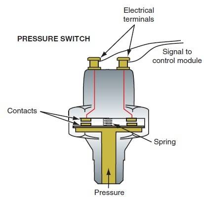

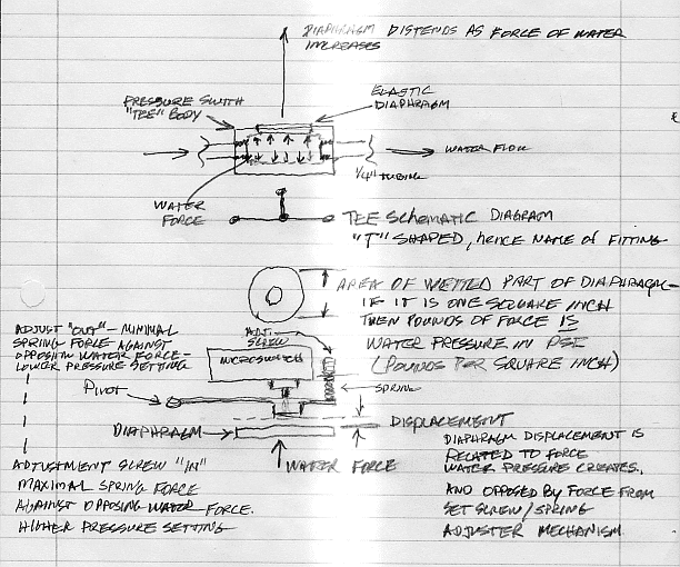

It's a pressure switch (not a 'flow' switch). In the simplest implementation, pressure switches include a moveable diaphragm where atmospheric pressure and a spring are on 1 side, and the fluid of interest on the other. When the force exerted by the fluid of interest exceeds the force of the spring+atmosphere, the diaphragm moves and actuates a switch. Some units allow adjustment to the spring (so that the trip point may be adjusted).

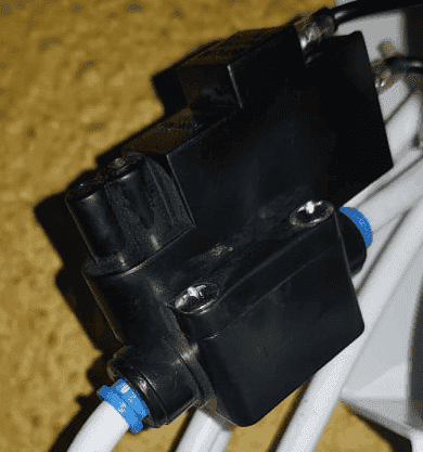

This is the actual unit in my reverse osmosis water purifier. When there is water flow from the uv cartridge to the faucet (the white tube with blue from right to left). It turns the uv lamp on (the two black wires became connected which turns on the uv lamp). I just want to know how the schematic of the internal mechanics look like. That's all.
You'll probably have to take it apart if you want specifics.

A typical pressure switch is this:
In the following there is inlet and outlet hole (left and right) instead of one input only like the above (at bottom with the "Pressure" level). So I assumed the following is a flow switch. Are you saying inside the following is a tiny version of the above?

Does this system have a drawing showing fluid paths, or could you sketch out where this pressure switch is plumbed into your system?
The Amazon listing calls it a "PureSec 2017 HPS14TUX2 quick fitting high pressure switch for tubing OD 1/4" used for RO system". Does this switch have additional information on a stick-on label, or molded into the case? I searched fairly extensively for manufacturer's specifications on this part, but found only other Amazon listings. Tried finding info on Empress EWP200 RO systems, but was only marginally more successful (mostly, sales promotional literature apparently for a company in the Philippines; all the link top level domains were .ph).
Many pressure switches are single port devices like the first one in post #9, and balance fluid pressure from the port against internal spring force. There are several different ways to go about it, but essentially if fluid force is greater than the spring force pushing back against it, the electrical contacts close to indicate high pressure has been sensed.
However, this photo shows a two port device suggesting another type of pressure switch called a differential pressure switch. In this type of pressure switch, fluid force at a second fluid port (port B) performs the function of an internal spring. If fluid pressure at port A is sufficiently higher than the pressure at port B then the switch contacts close to indicate high pressure exists.
The reason for sketching how it is plumbed into your system is, if it is a flow switch, total system water output will flow through it, but if it is comparing water pressure between two points in the system it is a differential pressure switch.

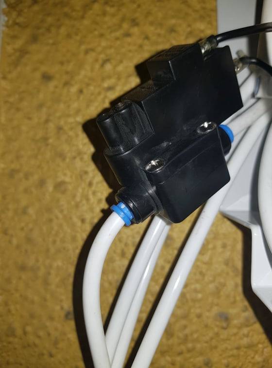

If you own a reverse osmosis water purifier. The connections are typical. Mine is like this:
The UV cartride is add-on, meaning not part of the package. And it is put in series to the faucet. In the high pressure switch in the following, the left side is directly connected to the faucet. So when the faucet is opened, there is a water flow from right to left and uv lamp turned on, and when no water flow in faucet, the switch supposed to turn off the uv lamp, but it stays on.
The technician will come next week. But I just want to have idea how the schematics of this work inside. That's all.

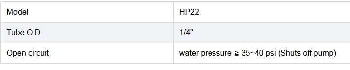

Thanks. That reference to a SoleAqua QF-HP22 to helps a bit, but not enough.
[Begin mini-rant]
Is it just me, or is product literature becoming abysmally useless?
This is the sum total of their specification page.
At least it gives a water pressure of 35 to 40 PSI, which I'm assuming is the operating set point adjustment range, but no mention of differential set point, or anything else like allowable temperature range, fluid compatibility, burst pressure, switch data (voltage, current, etc.), or, important to this discussion, an exploded drawing of it's inner workings.
[End mini-rant]
In general, pressure switches have two set points - the operating set point, and "deadband" or "differential" set point (not to be confused with it being a differential switch). The stated 35 to 40 PSI may indicate operating set point adjustment range (when the hex screw is turned all the way counter-clockwise it'll switch at 35 PSI, and switch at 40 PSI when turned completely clockwise), but that's just a guess. The differential set point may also be user-adjustable, but is often set to a fixed value by the manufacturer.
For example, if a pressure switch has an operating set point of 40 PSI and differential ("deadband") set point of 8 PSI, it will open at 40 PSI, and remain open until pressure drops below 32 PSI (40 PSI - 8 PSI, hence, differential).

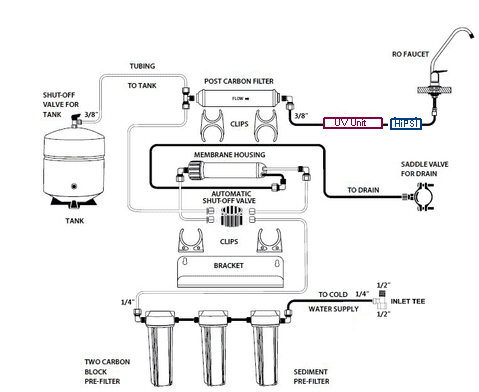

What are the two ports on your pressure switch connected to? In this marked-up sketch I've assumed one of them are on the outlet side of the UV treatment unit ... where does the other one go to?
It may turn out this particular switch simply isn't capable of switching on the UV unit when the faucet is opened. If sensed pressure differential between port A and port B never equals or exceeds 35 PSI, the switch will never actuate to the open position and turn off the UV unit, regardless of screw adjustment.

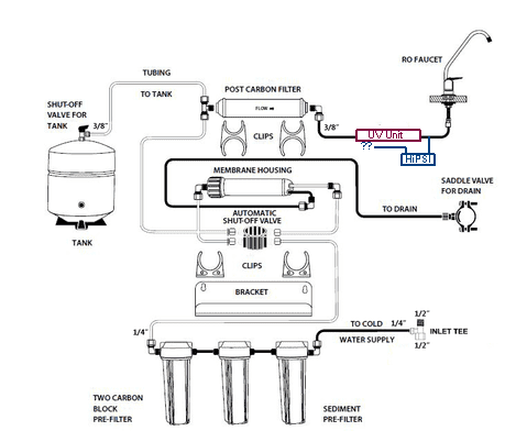

Here is how the high pressure swtich is connected to the system:
When the faucet is not being used. The UV lamp should be turned off. When it is not turn off. There is initial hot or warm water coming from faucet due to stuck water in the uv cartridge. My cousin didn't even install any high pressure switch. But I wanted to save the UV lamp when not in used.

Does the UV light turn off after the system has been left with a closed faucet all night?
Can you tell if the drain line stops running after the pressure tank fills?
Do you have a pressure gauge on the water service inlet to your house? What does it indicate?

I've never seen a pressure switch in series with total flow, but there it is. Scratch the differential pressure idea; it seems they've incorporated a traditional one-port pressure switch and tee into a single casing. The part in the eBay link is rated 0.25 MPa (36.3 PSI) +/- 0.02 MPa (+/- 2.9 PSI), and by a different manufacturer from yours.
What @rbelli1 asks in post #14 is key info ... what is the pressure at the pressure switch. If it never rises high enough to open the pressure switch contacts the UV disinfector will stay on regardless of whether the faucet is on or not.

The pro of using a pressure switch in this application is they're readily available and relatively cheap. The cons stem from using pressure as a proxy indicator of fluid flow.
With no flow, pressure at the faucet and UV unit connection will rise to pressure at the cold water supply, so long as there isn't any drainage flow through the RO membrane. Even without this factor, it will take some time for the pressure equalization to occur, and progressively more time as the filter elements become blocked with debris.
Imagine replacing the post-carbon filter with a variable orifice flow control valve. When the valve is fully open (mimicking a new, clean filter element) pressure drop across it will be very low, and pressure at the faucet will quickly approach supply pressure. Throttling the valve more toward the closed position mimics a filter element becoming progressively more blocked, and pressure drop across it will rise.​
Under no-flow conditions (as long as the filter isn't completely blocked, or flow control valve isn't completely closed) it will take progressively longer for pressure at the faucet to match supply pressure. When the faucet is opened with a clean filter, the pressure at the faucet and amount of flow shouldn't change very much over time. As the filter clogs (flow control valve is throttled) there will be a short period of normal flow through the faucet (and nearly supply pressure at the faucet) which will fairly rapidly fall to whatever reduced flow can make it through the throttled valve/partially blocked filter, and a corresponding reduction in pressure at the faucet.​
The same general idea holds as other filter elements become clogged, but since they are upstream from the pressure tank the effect won't be as immediate.​
Point is, there's a lot of things that affect pressure at the faucet that don't have anything to do with whether the faucet is open nor not, including variations in supply pressure.

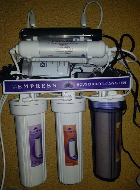

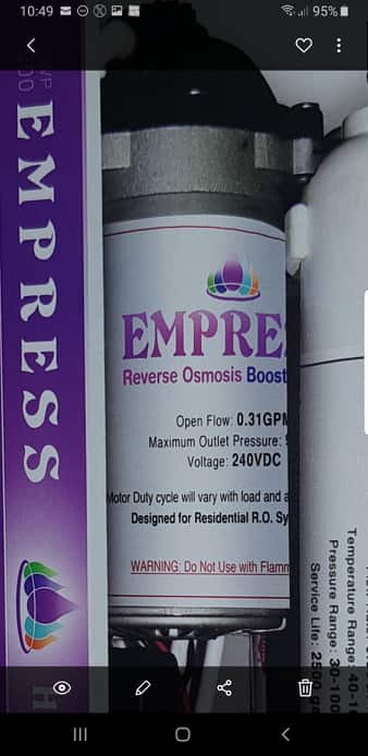

It's a household reverse osmosis system supplied by municipal water system. I used to have a separate house pump but since it's broken, we don't use it anymore, so house water pressure is not as strong. At least the water can reach the second floor.
But is it not the ro system pressure is separate from the municipal water pressure? Irregardless if the municipal water pressure is strong or weak, the ro system pump shuts down when tank is full. So it's not affected by the municipal water pressure (with regards to the high pressure switch system pressure), is this in the affirmative?
The diagram you posted did not have the pump and I did not notice it in the picture.
Yes, the presence of the pump should keep the pressure high in the system regardless of the city pressure.
BoB
The small half silver like tube at middle in the picture above is the pump. Here is zoom made vertical:
I'll know tomorrow after hex allen adjustment of the higher pressure switch if it would turn off uv lamp when faucet not in use.

Would it trigger it or only when the water pressure is exactly 35 psi?
It switches off at 35 or greater. The highest it can handle will be specified in the manual and maybe written on the switch itself. Carefully study the switch drawing that you posted.

It opens 0.5 second before use. So I guess I need to have the high pressure switch removed. My friends don't use high pressure switch and the uv lamp was continuously on since March of 2019.
Do you know what kind of adaptor or connector to connect the open tubes together after the high pressure switch is removed?

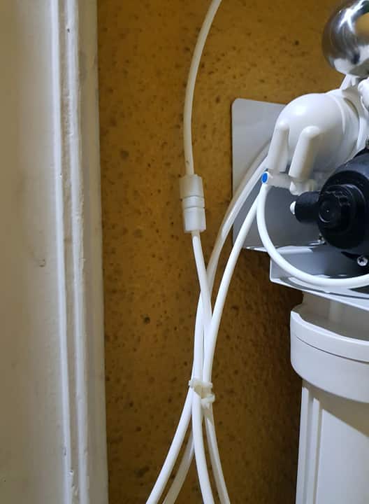

Not offhand, but you could:
1. Install a female-to-female adapter with 1/4" press fit connections on both sides,
2. Get a small roll of 1/4" tubing and replace the tubing segment, or,
3. Simply leave the high pressure switch in place. Disconnect the two wires going to the switch contacts, and connect them to one another (be sure the power is off before doing so).

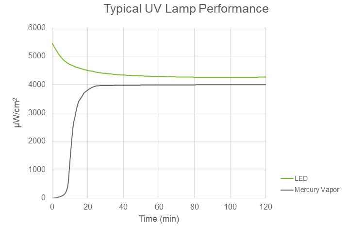

Can't the UV lamp reach full potential in 0.5 seconds.. does uv lamp or any fluorescent lamp really need 3 minutes for maximum output?
Quite often, yes.
If you know the bulb manufacturer and part number, see if they provide warm-up curves. This one courtesy of Magnaflux is typical. https://www.magnaflux.com/Magnaflux/Resources/Blog/NDT-Stabilize-vs-Warm-Up

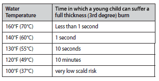

If I turn on the uv lamp all day. I notice the initial water from faucet is hot. This is because the stuck water is exposed to the uv light for hours. My concern about this is the quartz tube inside the uv cartridge is not build for high temperature.. so maybe there may be chemical reactions that may occur?
How hot is the water? Boiling hot?
A quartz tube is capable of enduring higher temperatures than ordinary glass, or even borosilicate glasses like Pyrex used in lab glassware and home cookware, so I wouldn't worry about it.

Not boiling hot. Just hot but I can still run my fingers across that initial hot water from faucet. Not even sure it's the same as pyrex quartz used in laboratory. Remember the uv lamp cartridge is meant to have normal water temperature running through it.
Also if you will see the Empess ro system in the picture above. The UV cartridge is not included. It is just extra added by user. The company argument is that the 5 stage ro system is enough to filter and have clean water. Do you think 5 stage ro system is good enough without the additional uv cartridge?
I'll find connector/adaptor to connect the two white ends. Then i'll let technician remove the high pressure switch and open it up so we can see what's inside. I'll share picture of it later this week. Thanks for all comments.
That you can hold your fingers in the warmed water stream suggests it isn't even to 60°C (140°F). Unless water temperature rises enough to be a scald hazard it isn't something to worry about.
I'd note the UV disinfector manufacturer takes into account the effect of water temperature rise after prolonged periods of no water flow.
