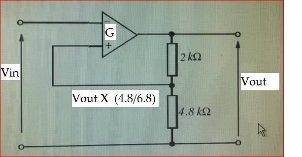

FIGURE 2 shows an op-amp circuit with a constant input voltage V connected to the inverting input. If the output
voltage is +2.4 V, calculate the value of V.
Schmitt trigger values:
R1=4.8 ohms
R2=2 ohms
V OUT= +2.4V
V+=(R1*V SAT)/(R1+R2)
V+=11.52/6.8=1.69V
Now this is the Reference Voltage going to the non inverting terminal but I'm lost as to where to go from here, this would indicate that V is less than 1.69?
Any help to point me in the right direction would be much appreciated. This is the first time I've studied the electronics side of things and it's safe to say I'm struggling a little.

Where is "FIGURE 2"? We'll need to see the circuit if we're to check your attempt or offer advice.
Sorry about that. Please see attached.

In this circuit feedback is provided from the output to the input via a voltage divider (R1 & R2). The result is to "lift" the potential of the + input of the op amp by a fraction of the output voltage. If the output happens to be positive, then this "lift" is also positive. The very large gain of the op amp will ensure that this "lift" will be driven towards matching the potential at the - input of the op amp (enforcing a zero potential difference between the inputs).
You should be able to derive this result by first assuming that the op amp has some finite gain A and writing the circuit equations to solve for ##V_{out}## in terms of ##V_{in}##, then taking the limit as A gets very large.
uhhh,, mr stripes
as drawn
that opamp has positive feedback , so it can't drive its inputs equal unless its gain A were to be negative.
mr gniel has hinted at that
gneill said:
Why don't you try assuming some finite gain "A" for the op-amp and writing an expression for the output voltage for a given input voltage? Then you can see what happens when the gain is allowed to be very large. Don't assume any non-linear (Schmitt or comparator) qualities at the outset.
your calculation for V+ in post 1 is correct, to the digits you showed

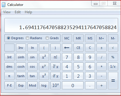

First I calculated V+ by using:
V+ = (R1*Vout)/(R1+Rf)
V+ = 11520/6800
V+ = 1.694V

you'll see gneill's point that if the circuit is "operating", ie output not saturated, amplifier's inputs must be different by Vout/A .
Now
you mentioned A of Rf/R1
make yourself aware that there's two different gains
one is the gain of the raw amplifier by itself, usually quite high for op-amps, like 10^5
the other is the gain of a circuit encompassing an op-amp which the circuit designer makes whatever he wants by selecting resistors for feedback and input. That one we call "closed loop gain" .
So long as the amplifier is able to push its inputs equal, it can be said to be "operating" that's why we call it an operational amplifier circuit.
In the circuit you presented
the amplifier is unable to push its inputs equal
look - raising V will lower Vout driving the inputs farther apart
so that question is either badly phrased or a trick question,
i'd say an unfair one to give to a beginner
we must rigorously do the arithmetic to get the answers
but if you build that circuit and apply input that you can adjust with a knob
you will be unable to hold Vout steady. It's a math dream only.

Do you see now that circuit is counter-intuitive?
They have fixed Vout at 2.4 volts and ask you to calculate the Vin that would cause that Vout .
That's working the circuit backward. Adding insult to injury, the circuit is unstable .
Very confusing and unfair to treat a beginner that way.

If gain =## \frac {Δoutput}{Δinput}##
what is the Δin required to cause a one volt change at output ?
G X ( Vout X (4.8/6.8) - Vin ) = Vout
Vin = Vout/G + Vout X (4.8/6.8)
Vin = Vout X (1/G + 4.8/6.8)
so the circuit can exist precariously balanced at any input Vin = Vout X (1/G + 4.8/6.8)
but if Vin moves one single nanovolt away from that value
positive feedback will move the + input AWAY from that balance , causing more imbalance
by the time Δoutput reaches our 1 volt, imbalance at input has grown from our nanovolt to (1/G + 4.8/6.8 +1X10-9) volts
that's what positive feedback does, instead of balancing things it further unbalances them
so our gain of ##\frac {Δoutput}{Δinput}## has a denominator that's made infinitesimal by positive feedback
that's what positive feedback does, raises gain.

But how do you define the 'gain' of a bistable circuit ?
I submit that "Gain of a schmitt trigger" is an oxymoron, undefinable or at best infinite. Bistable is a discontinuous math function.
So, once again , your exercise postulates a condition that's mathematically possible but not practically achievable
unless Vsat is 2.4 volts (which was not given)
in which case any Vin less than 2.4 X(4.8/6.8) volts will keep output saturated
and that is this many volts
so, yes, V < 1.69 is a plausible answer ..
but it's not the one i would have inferred from this question:
because it needn't be constant, just < 1.69etc
was i off track much ?
hope i didnt hurt you on this one.
old jim
the-brammo said:
The input could be a varying value, maybe you should think about using an inequality?
He nailed it in post 23 .

Just to confirm though, there is no equation for an accurate input voltage of a schmitt trigger?
  • #32
Input voltage that'll cause what condition?
It is easy to calculate the voltage at which the schmitt will switch output states.
It is not physically possible to apply an input voltage that will hold its output in between those two states, in its linear region , as i interpreted your original post.
you can calculate such a voltage but it is not practical to measure let alone control to the required precision
because changing the applied voltage in the last digit by just one
will start the positive feedback loop on its merry way to saturation.
I'm not dodging your question just trying to answer it precisely.
