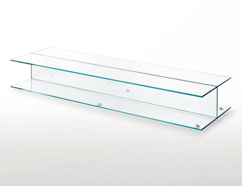

Do you understand why "I-Beam" shapes are used for beams? Do you understand why triangle shapes are used for bracing? Using just a long thin beam is not the best way to ensure good strength... :smile:
http://www.ema-models.co.uk/media/catalog/category/H.jpg
Likes Tone L
