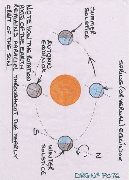

Take a look at these attached sketches also:
(main sketch and enlarged views of the solstices)
(you will have to rotate them)
The red line is a daily path of a point at about 45 degrees latitude above the equator.

Likes John Gibson and MisterAmrani
